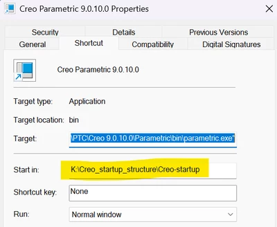

I don't know why you are using scripts etc. to make a centralized config possible.
The easiest way, my company uses it for more than 2 decades, is to set the [Start-in] directory.
You can do this by right clicking the CREO Start-UP button (Most probably shortcut on the Desktop) and select [Properties].
The K drive (server) is the location where the config file is.

@BenLoosli likely has the best answer for you but to expand on that, most medium to larger companies have startup scripts that do things like setup standards, delete extra files and maybe configure licensing. PTC fairly recently added an environment variable option to point to configuration options. You could define this environment variable in your startup script. More info on startup scripts here:
https://community.ptc.com/sejnu66972/attachments/sejnu66972/installation_licensing/1673/1/ProE%20Launch%20Script.docx
