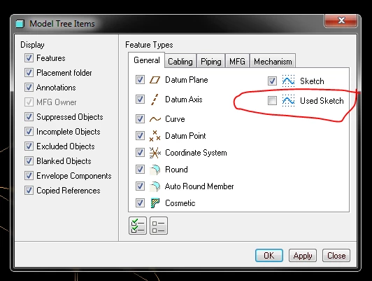

The sketches should still exist in the tree where they were and be available for other uses. They will just be hidden. It’s possible your model tree is set not to show them. Go to Settings > Tree Filters and make sure ‘Used Sketch’ isn’t cleared:
[cid:image001.png@01CE19C0.1091F820]

The sketches are still there, though they have their feature number removed and are "consumed" into the Intersect feature (have to click on the '+' symbol to see them in the MT). But they are locked up. I can't do anything with them. If I do what Brent suggests, I can have multiple copies of the same sketch, but I have to do that Jeff

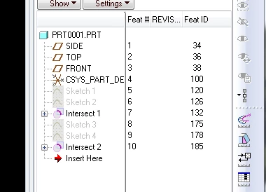

Can you give me a step by step on how you duplicated what he did? I created two sketches, selected the two features and selected edit > intersect. I then created two more sketches, selected the sketch geometry (fat red line) of the two and selected edit > intersect. I got the same result:
[cid:image001.png@01CE1A4B.4FF61600]
If I change the model tree display like I showed earlier I see this:
[cid:image004.png@01CE1A4B.C72652D0]
I can still edit or edit definition on all the sketches, however.
