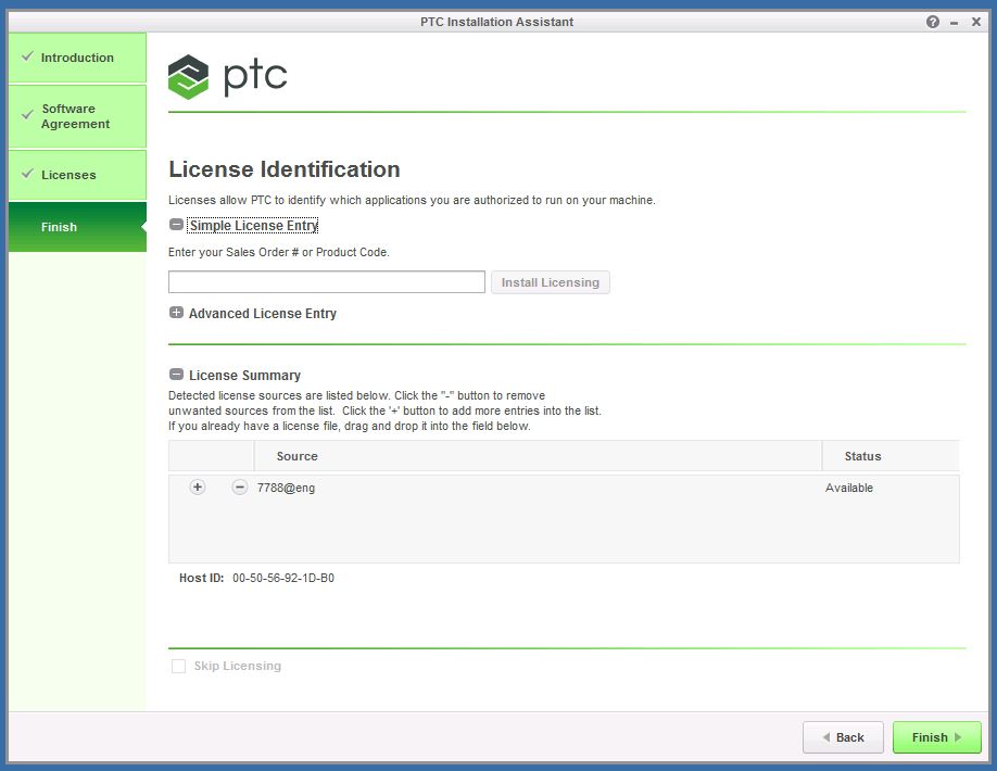

How do I install the latest FLEX license manager?  I installed Creo 4 but there wasn't an option to install the license server.  I'm running Creo 3 today.
June 2, 2017
There should be an option in PTCsetup for installing the license server.
Creo 4 does not require a new FlexNet server install, only a Creo 4 license needs to be installed on the existing server.
June 2, 2017
There's nothing to select.  I'm running FLEX license sever from WF5.  I'll trying loading the Creo 4 license file and see what happens.
Mahesh_Sharma
22-Sapphire I
June 2, 2017
Adam,
Setup is reading the information from existing server. For Creo 4.0 you need to uninstall the license manager and install newer version from Creo 4.0 disk.
Once you will execute Creo 4.0 setup from Disk, you will find the option for Setup License. It will not be available if you will reconfigure.
