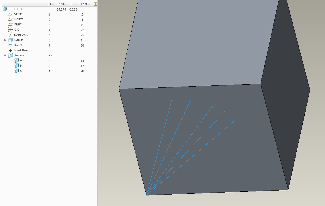

Hi All,
I'm using Creo 3 and am unable to find a solution. I am wondering if it is possible to display sketcher lines while outside of sketcher mode when creating a part. Let's say you have a simple cube made from an extrude and you then select a face of that cube to draw on--a line for this example's sake. Once I click okay and exit sketcher mode, the line is not visible unless I hover my cursor directly over it. In my line of work this can sometimes be a major annoyance and I'd like to see sketches outside of sketcher if possible. Is there a way to change this?

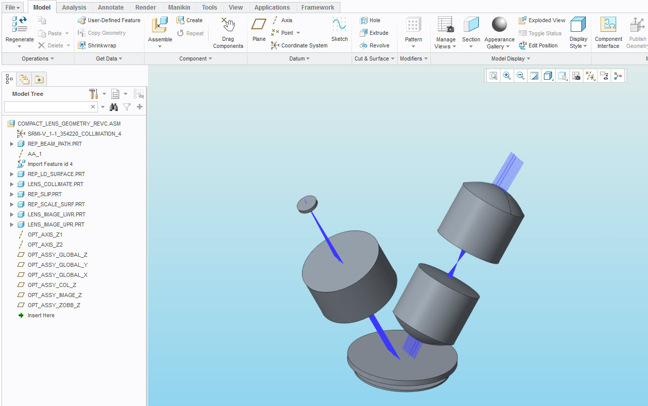

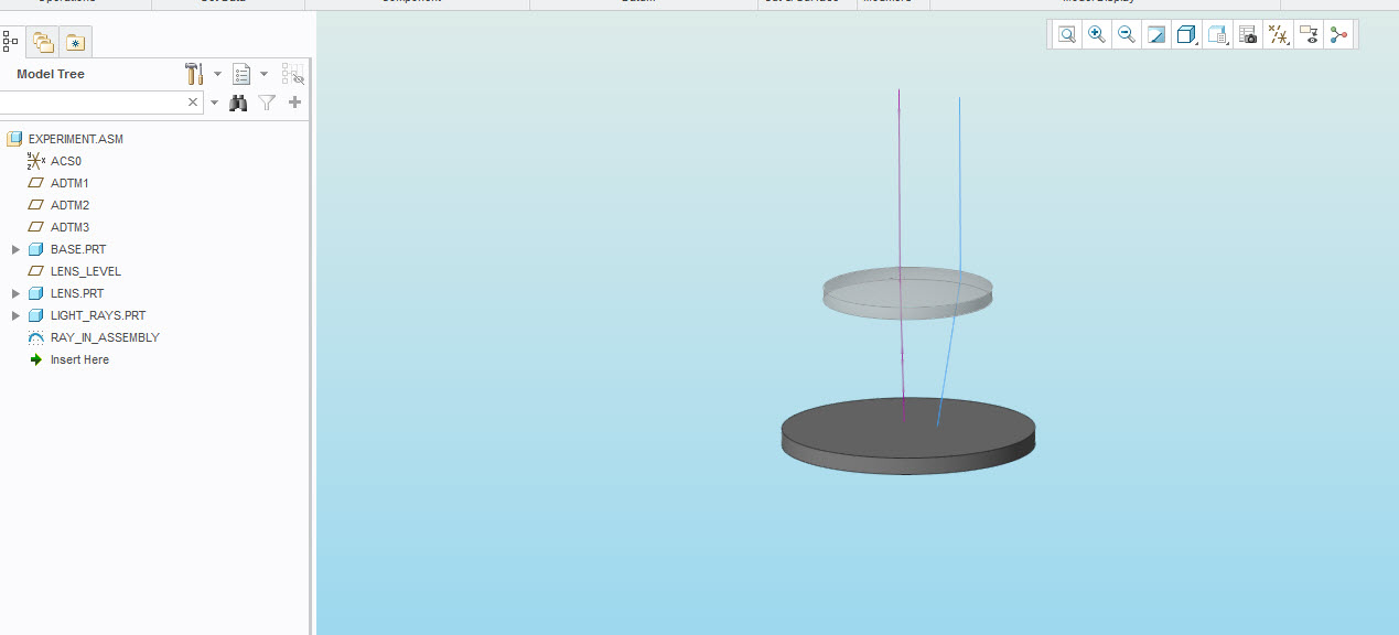

I've already looked at layers and came up empty handed. The layer display changed, but only when I was in sketcher mode. It didn't make the sketch viewable after exiting sketcher. What options and config settings change sketch display outside of sketcher? I think that will get me there faster than a screenshot that won't show much.
Also, I understand that sketcher is usually used for features, but in this case (not always) I am working with optical light rays. They are zero thickness in essence, but I want to treat them as lines so I can then dynamically change angles, lengths, etc. of the light rays and constrain other features to them. I can do this as is, but I have to hover over the datum line to even see it. It is difficult to select the correct ray when there are 100+ of them and you can only see them when you hover over. I found that a temporary workaround is to view the model in a wireframe mode, but this isn't a 100% perfect solution for me.

Let me make sure I am guessing what is happening to you correctly.
You make a sketch on a face of an already made cube.
The sketch consists of a line.
When you click on the green arrow to accept and finalize the sketch, the line "disappears".
Subsequently, when you hover over the area of the cube where you "painted" this line, then the line is highlighted.  This rules out the possibility that the sketch has been placed on a blanked layer automatically.  By default your sketches will be automatically hidden if you use them as the basis for other features (extrudes or revolves).  But that's not what you are doing, so basically, I think that either: a) you have a graphics card issue or b) your colors are such that the sketched lines are hard to see in the graphics area...  Try switching to a "wireframe" display mode, to see if the line is indeed there (--> problem b).   Also try setting the config.pro setting graphics win32_gdi (problem -->a).
mperkins1-VisitorAuthor
December 2, 2016
The first part of your post is correct in terms of the symptoms I'm experiencing and example given.
I looked at layers and this doesn't appear to be a factor.
I don't always use these sketches for subsequent geometry, and in fact they disappear before I get to that point either way. I don't think it is a graphics card issue because my coworkers experience the same thing. I also have a decently beefy graphics card and think the win32_gdi setting is oriented more for low end cards, correct? A quick Google search said to only switch from OpenGL to that if you were experiencing issues due to hardware limitations. I have my card running at full AA with high quality edges and most of the other graphics enhancements and it doesn't bat an eye, so I am skeptical in thinking that my card can't handle what I'm asking.
