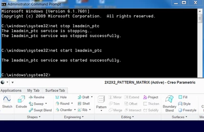

to manage lmadmin_ptc service status:
  • open Command Prompt as Administrator
  • to stop the service, use command ... net stop lmadmin_ptc
  • to start the service, use command ... net start lmadmin_ptc

July 5, 2017
MH
July 5, 2017
This looks promising, Martin.
I will update this post if this works next time.
July 9, 2017
Thanks again, Martin.  That did the trick.  A few seconds for the stop process and almost immediate on the start.

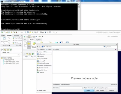

I noticed another very troubling thing after sleep mode...
I can open more than one unassociated window in Creo at some point.
Literally starting 2 instances of Creo!
I was able to do this before implementing your solution.
When I look for "in session" files, they are completely independent.
Now mind you, I only loaded Creo 2.0 M040 on this computer.
I have not used any later installers.
This is two open session on a single locked license...
I use to get a license error when I did this on my Dell M6600 with the older license server.
Notice the 1st open session with a loaded file and the second session that has no files in-session!
Anyone else able to do this?  Is this the "new normal" (noting that I had a very old license server before...)?
I doubt this is a license problem as this is the same machine.
Just never could do this before... and I wonder if it could generate file problems.
