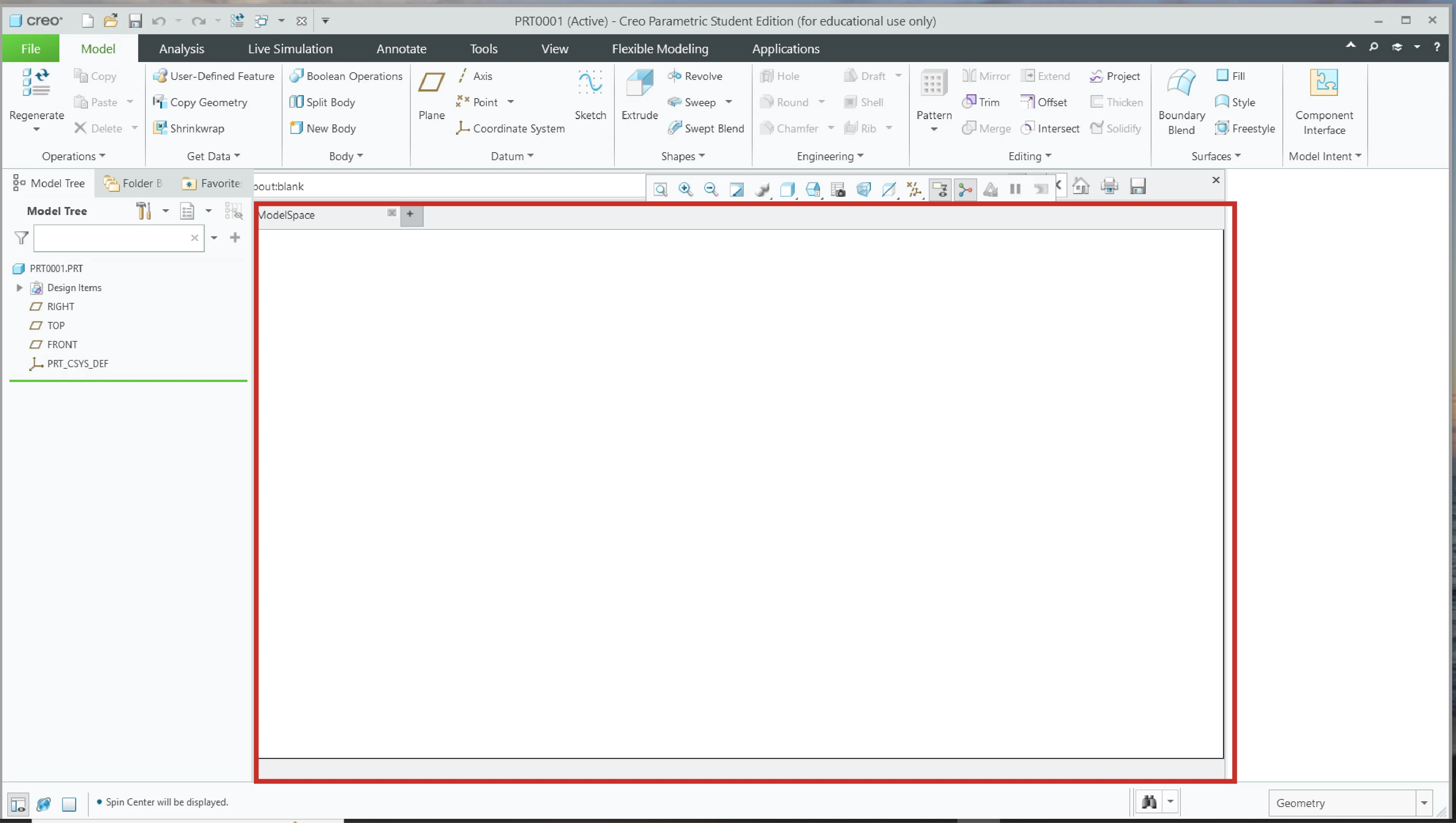

I've installed multiple versions of Creo 3, 6, 9 and on all of them, there is no active part window when opening the program. I'm able to create a new part file but nothing opens on the screen and the only windows that remain open are the startup ones which I can't seem to turn off. Since it's happened on numerous versions, can you recommend some fixes as it's obviously something wrong with my computer?
It has a NVIDIA 940mx 2GB graphics card running Windows 10 on a Intel i7 chip with 16 GB or ram. Didn't know if I need to install a driver or something?
Thank you for your thoughts!

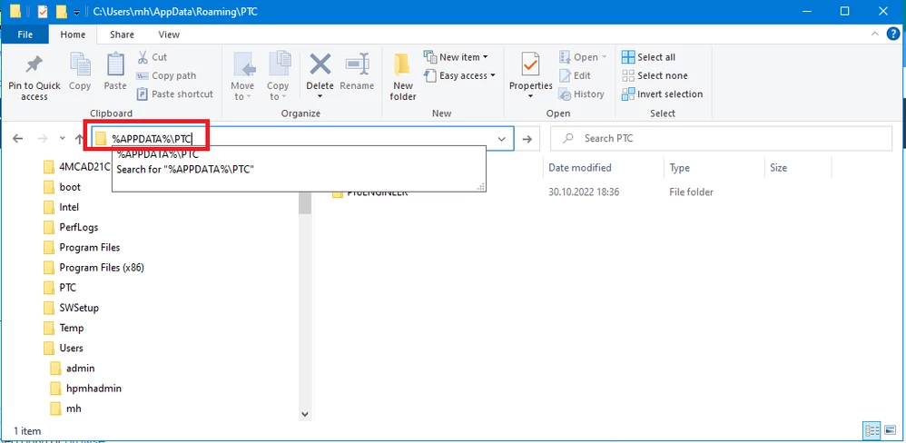

1.] config.pro
I suggest you to edit "main" config.pro.
In my Creo 9.0 it is located in E:\PTC\Creo9_020\Creo 9.0.2.0\Common Files\text directory.
2.] PTC subdirectory
You have to copy %APPDATA%\PTC into input field of File Explorer, see picture.
Under my login %APPDATA%\PTC is translated to C:\Users\mh\AppData\Roaming\PTC.
You can rename PTC subdirectory. Next Creo start will recreate the directory.

please publish screenshot showing what is displayed in the monitor after starting Creo.
Nov 14, 2022 9:19 PM UTC

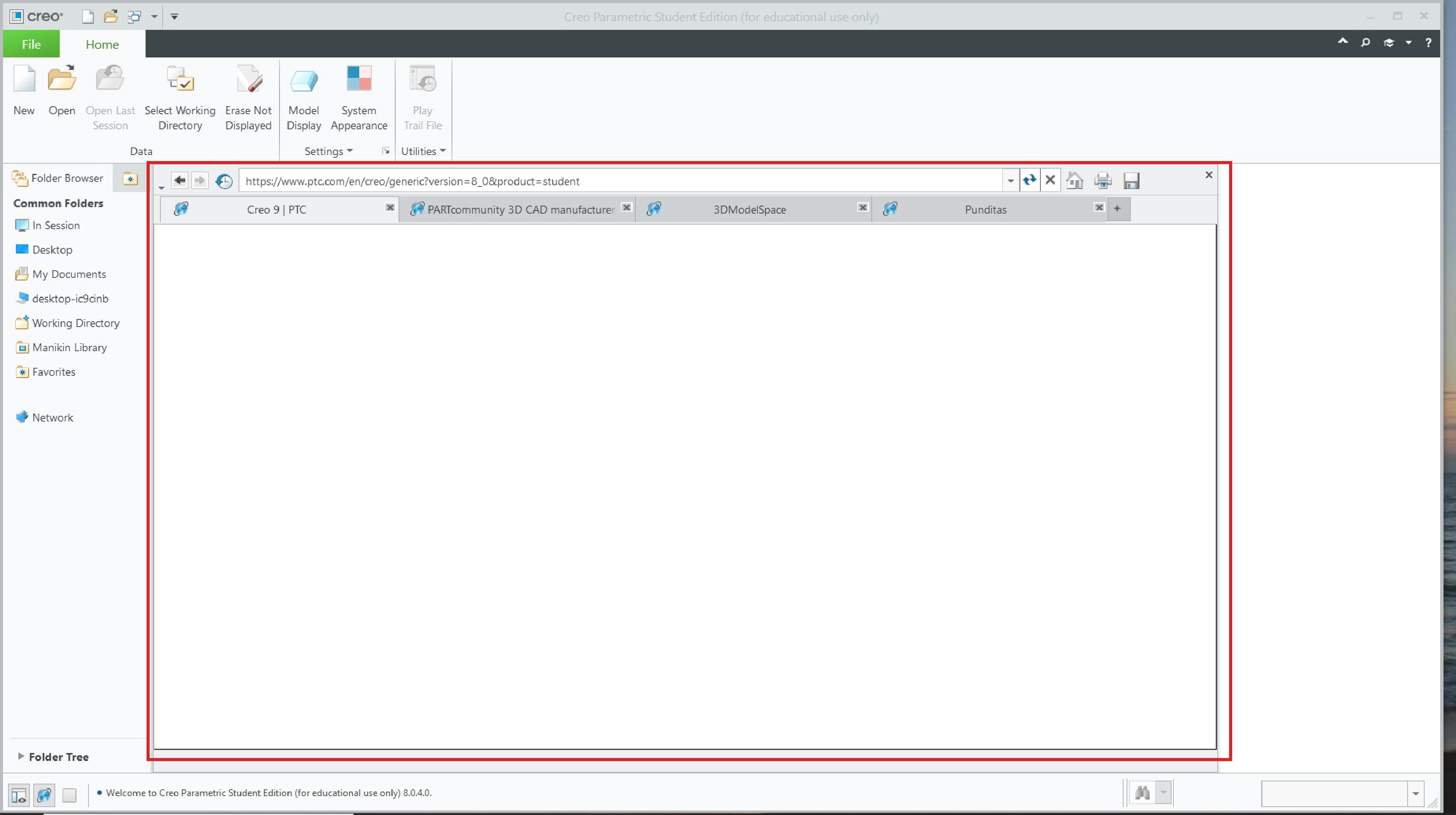

Hi Martin,
Thank you for your assistance! Please see attached an image of the startup page along with another page where we tried to create a new "Part". For the startup, I was able to close the internet windows that pop up and create the new "Part" but then as you can in both images, the middle of the screen is totally blank (indicated with red boxes) and we can't access anything inside of the window. There's no geometry in the window.
Do you think this is a problem with our computer? Missing a driver or something?
We tried to install various versions thinking perhaps an older one would work but alas, they all have the same problem.
Thank you for your continued assistance and we'll await your thoughts!

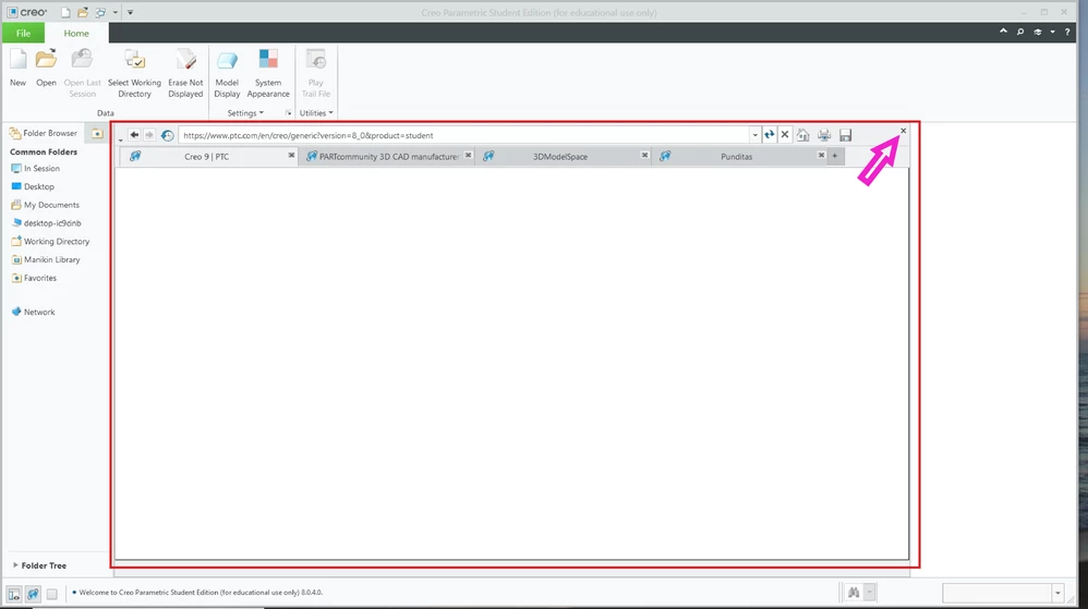

area inside red rectangle belongs to integrated browser. You can close this subwindow by clicking cross button in its top right corner.
