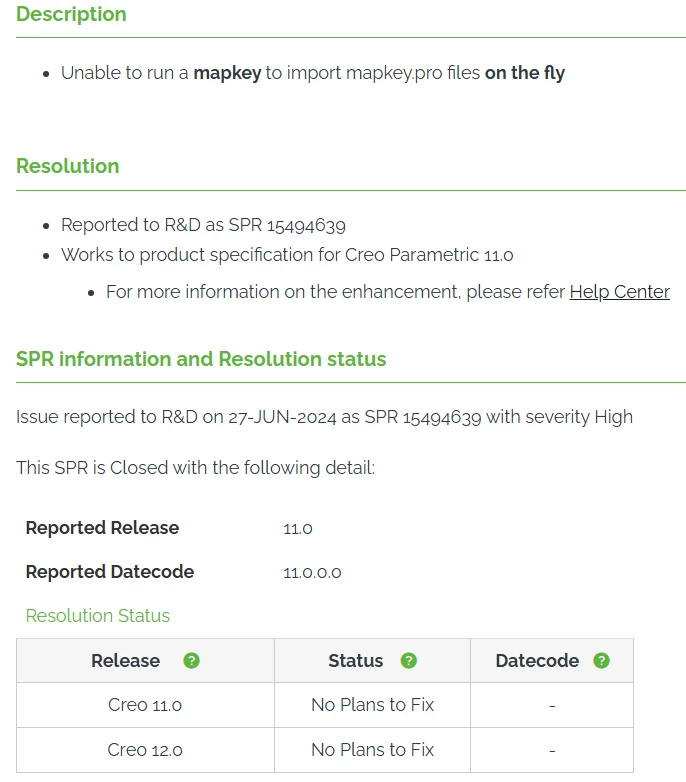

Mapkey toggle scheme no longer works in Creo 11+
Creo 11+ toggle mapkey schemes that call config.pro files on the fly from within the mapkeys no longer work. This was to be expected with the introduction of the mapkey.pro file to define mapkeys, however I am not able to record a mapkey that will load a mapkey.pro file on the fly thereby rendering the toggle strategy dead.
Has anyone been able to update a toggle type mapkey to work in Creo 11 yet. I would be interested to see how you are loading mapkey.pro files on the fly using a mapkey.
I am still able to load config.pro files on the fly using a mapkey in tests but no luck with the mapkey.pro files.

Jun 27, 2024 10:24 PM UTC
PTC support has confirmed today that it is not possible to load mapkey.pro on the fly and a high severity SPR has been assigned to the issue. I will update this post when a solution is implemented.

Nov 20, 2024 5:30 PM UTC
R&D has an example of a workaround, I am waiting to get it and test it to see if it resolves the issue. The SPR is closed. I will add information here once I get a chance to test the proposed solution.
The stated resolution from PTC is: Mapkeys can be loaded/Imported from File > Options > Mapkeys Settings
