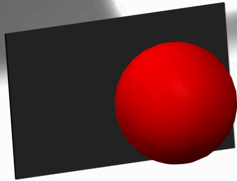

I have created a small timber cabinet in Creo Parametric(academic edition) which has a mirror inserted into door.
I can't seem to be able to select a material that represents a mirror in the final render. The only option I can think of is to select glass and edit the reflective settings, however in the final render its still see through.
Any ideas?

Transparency affects how easily you can see through a material.
I'm pretty sure the renderer in Creo Parametric is not a ray tracer; any reflections are only of the images that are placed on the walls, floor, and ceiling of the room environment in the render settings.

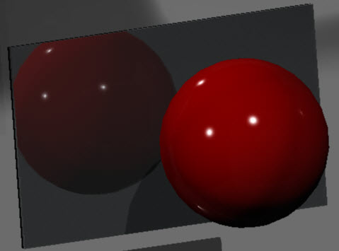

Can you switch (in Render Setup) the Renderer from PhotoRender to Photolux?
The latter is a Raytracer and can calculate mirror reflections (for example for metal like surfaces)

BTW: I created a simple example, building a mirror with two mated plates, one with PTC-glass appearance and the other in black, then place a bin front.
See below the results with PhotoRender (no mirroring) and Photolux (mirrored):
Photorender:
Photolux:
