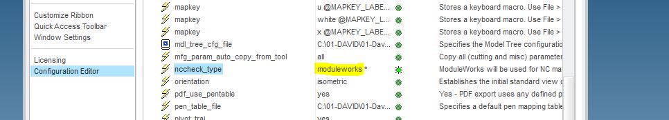

Hi all, just read this in article CS226148,
  • ModuleWorks will replace NCCHECK & VERICUT starting from versions below:
    • Creo Parametric 2.0 M210
    • Creo Parametric 3.0 M090
  • Starting from above versions, Vericut won't be available for use anymore
    • To perform material removal simulation, select NC sequence from model tree > RMB > Material Removal Simulation, it will access ModuleWorks
    • The default value of config.pro option nccheck_type is changed to moduleworks
  • Main Reasons of the choice of ModuleWorks is that :
    • It offers the capability to Simulate Material Removal Embedded in Creo Parametric (Only NCCHECK allowed that)
    • It is not limited as NCCHECK was in the past
    • It allows usage of OpenGL libraries used by Creo and improves by this way User Experience (possible smooth rotations of the manufacturing assembly in Creo When Material is being removed in ModuleWorks)
What do you think about this ? Do you know ModuleWorks ?

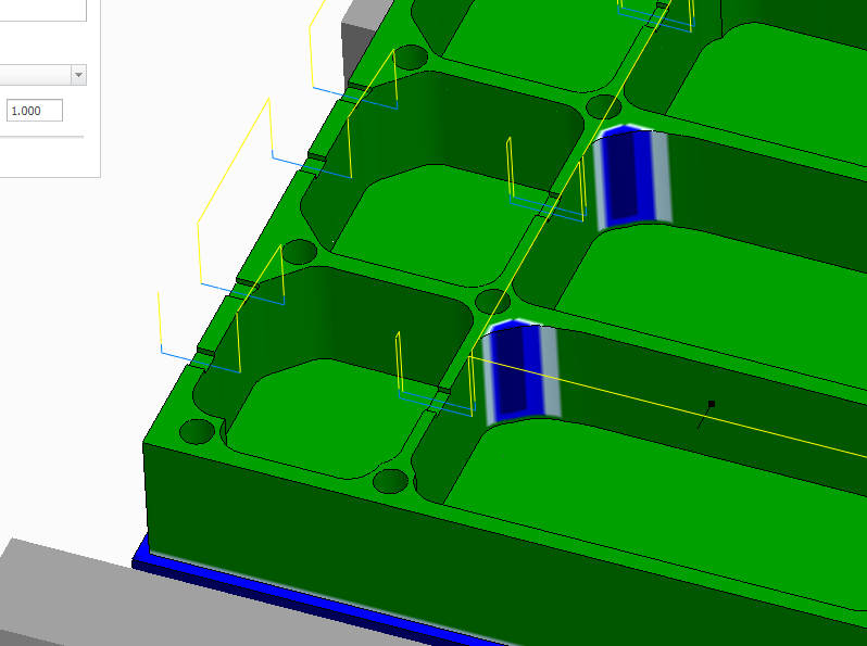

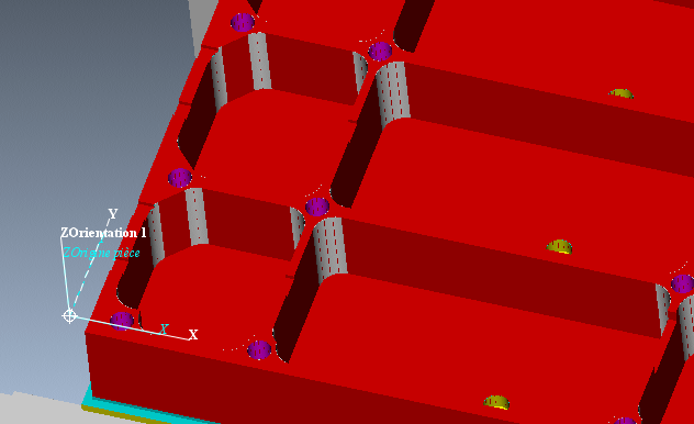

April 1, 2016
Creo 3.0 M090 was released yesterday, so I tested ModuleWorks. Bad start for this tool, on the first part I tested, it leaves material in two corners where it shouldn't. I know the program works fine as the parts have been milled without any problem. Vericut simulates this part correctly ! I'm a bit disappointed about this.
On the image below, the blue surfaces are the areas where stock material is not milled.
Simulation with vericut below.
I opened a support case about this.

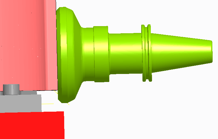

I've been testing Creo 3 with this and have uncovered 2 major problems.
1. The simulation claims that there is a collision between tool and fixture when there isn't any. This happens multiple times. I assume that it has something to do with the 45 deg. face mill being used.

RaphMORIN16-PearlAuthor
April 6, 2016
Hi Thomas,
Have you tried to modify the parameters I've coloured on the image below ?
April 6, 2016
Raphael,
I did not see those settings yesterday. Changing them fixed the collision problems. Thanks!

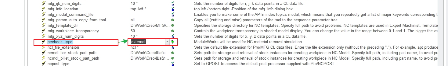

Dear users!
What do you think, what is needed Creo configuration option: nccheck = external?
How does this option?
April 7, 2016
Follows the image
April 7, 2016
No. This option 3 -External
