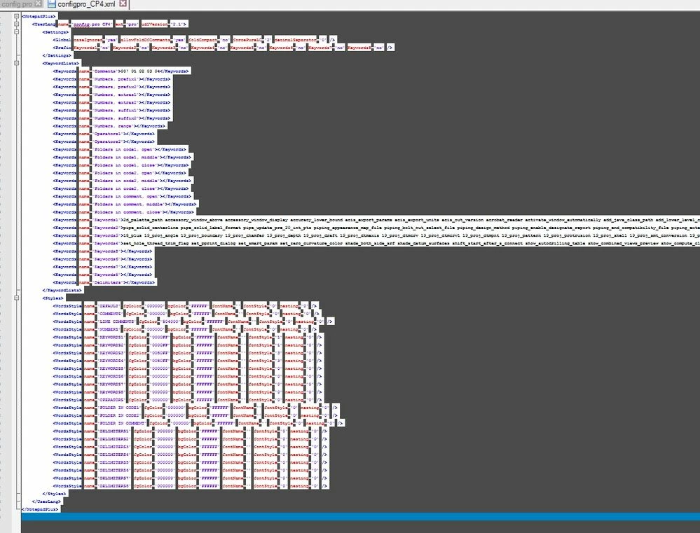

Oct 3, 2017 10:11 AM UTC
When I open CP4 in Note++ I only have 65 lines (all unfolded)...temp.jpgand the config options are all next to each other..??
DomenicLaritz
Nov 2, 2017 1:58 PM UTC
Hi FST,
you're right, there are many options next to each other.
But this is how the User Defined Language files in Notepad++ work.
So, don't worry about that.

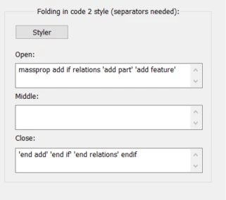

Does anybody have a Notepad++ UDL for Pro/Program??
Regards, Steve
Aug 17, 2021 8:47 PM UTC
@seckart I know that this is a few years late - but I don't have the full udl set up, but did get the basic setup for some of the pro/program keywords which you can just type in to the 'Folding in code 2 style' box in the UDL setup
Hope this helps
