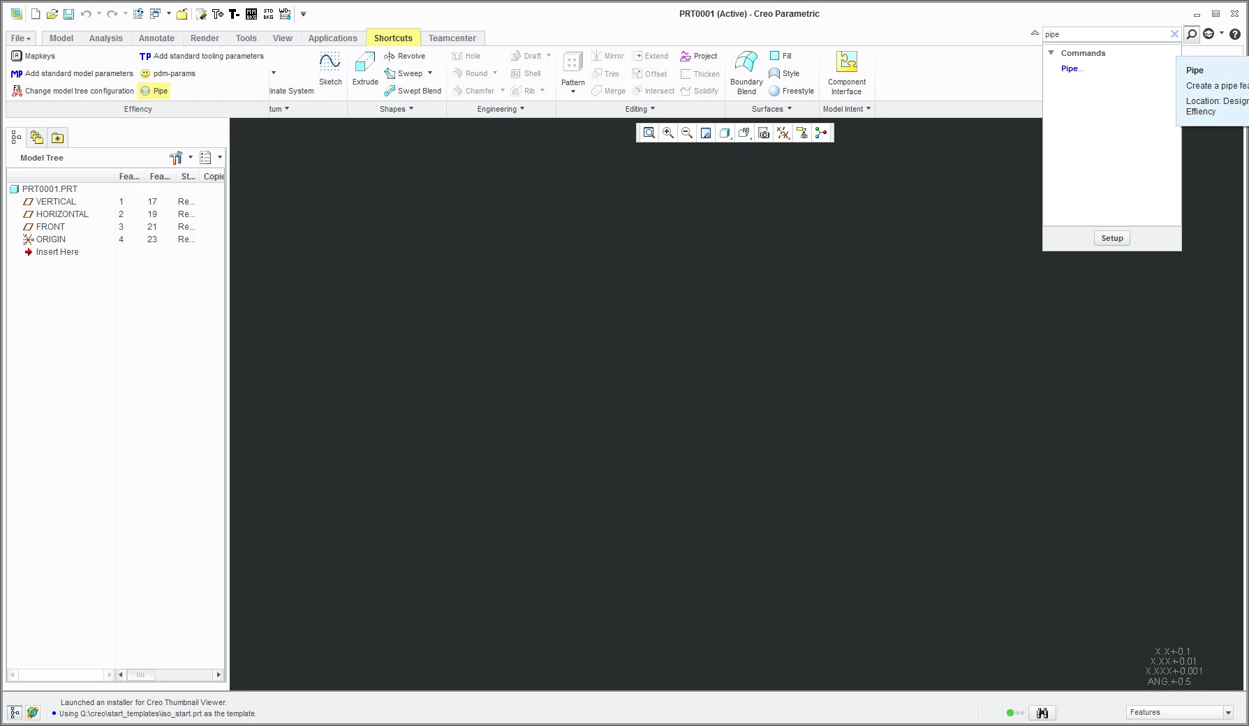

I'm not sure where they put it but if you select the magnifying glass in the top right hand corner and type PIPE in the box, it opens it for you. Unfortunately it doesn't tell you where it came from and it's the old menu manager so it's not in the ribbon.
When I looked to add it to the ribbon, if you go to all commands, it's listed there but you can't add it to a ribbon. Hmmm...

Norm,
You can still get to it in part mode. You have to access it thru the command search tool at the top of the screen. do a search for pipe. Would think other companies that use tubing thathave not purchased thepiping module would still want this in place to be able to geenerate pipe bend data tables automaticly.
I ended up creating a shortcut tab for my creo parameteric session. Not sure why PTC left it out of the default ribbion interface.

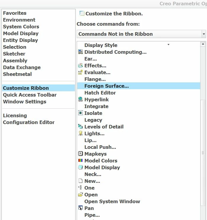

Jan 9, 2014 12:58 AM UTC
Hi Norm
Pipe command can still be found in part mode but you will have use the search command, or customize the ribbon and look at the section Commands not in the ribbon.
