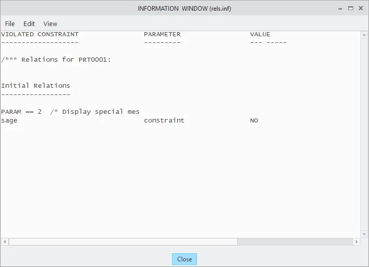

I am trying to find a simple way to prompt a warning when certain design conditions exist.   We use layouts to configure large models.  It is possible for somebody to configure a unit that may cause interferences or other issues.  without getting into too much detail about the specifics, I am simply looking for a way to prompt a dialog box or some sort of warning to tell a user, "hey, you better check this, it may not be something, but it could be".
In the most basic terms, If parameter X  is a certain value, or could be a combination of parameters, bring up a dialog box or really anything that would allow a specific message to be displayed.  Could even be a message in the message area at the bottom of the screen, but from my understanding, that would be done in toolkit, and I am looking for something through relations and ProProgram. I am not looking for any additional software of plug-ins, etc.

There is nothing in Creo relations that will allow you to create a pop up dialog box (in the traditional sense.)  For that you would need to do some type of custom programming in VBA, J-Link, Toolkit, etc.  The only possible workaround I'm aware of it to intentionally create an invalid constraint.  For example, copy this text to the relations dialog, close the dialog, and then regenerate the model.
PARAM = 1
PARAM == 2 /* Display special message
You should see something like this:
Hopefully that's enough to get someone's attention.

I really don't know what Toolkit is capable of.  I guess if he could hook into relations execution then maybe he could intercept certain custom commands and do something with them (like create a pop up), but I really don't know.  Maybe post that question over on the Creo Parametric Customization board.
