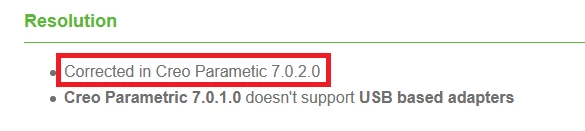

Support for USB adapters WAS intentionally removed in Creo 7.0.1.0.
https://www.ptc.com/en/support/article/CS329290

August 26, 2020
Looks like PTC is removing this restriction in the next Creo 7 release.  KB article was just updated today:
August 26, 2020
You will just have to wait until November when Creo 7.0.2 is released.
August 26, 2020
Hi CreOUser,
Thanks for bringing this up. PTC is aware of the change and it will be fixed in 7.0.2.0. This was the result of a licensing change due to how Windows 10 queries MAC addresses from physical and virtual adapters. For node-locked licenses, unfortunately there is no workaround for 7.0.1.0 other than using a PCI based adapter. This change does not affect floating licenses, however.
Best,
Nihal Velpanur
Creo Product Management
