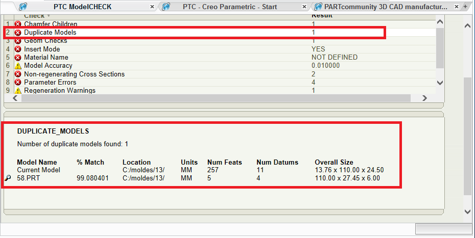

I'm not a user of modelcheck, but I tried and it seems to work on Creo 3.
It even creates a preview of duplicated models. It's not dependent of the UCS but it is scale dependent.
February 3, 2017
Here are the configs I used.
1 - Extract this file to a network folder/mapped drive (to a multi-user usage)
2 - Add the location to config.pro, something like:
modelcheck_dir t:\MODEL_CHECK_CONFIGURATION
3 - Correct the paths inside the files:
...\MODEL_CHECK_CONFIGURATION\config\config_init.mc
...\MODEL_CHECK_CONFIGURATION\mc_dup_write\Append_data.bat
4 - Open Creo, run ModelCheck on some models, Close Creo
5 - Check folder ...\MODEL_CHECK_CONFIGURATION\mc_dup_write
a new file should appear, something like mc_dupl_user_201702032114.bin,
Modelcheck will create this files when you close Creo and you have to append them manually to the database.
To do that you only have to run the file Append_data.bat
I haven't explored this extensively but this is a good kickstart for who is interested.
Jose.
