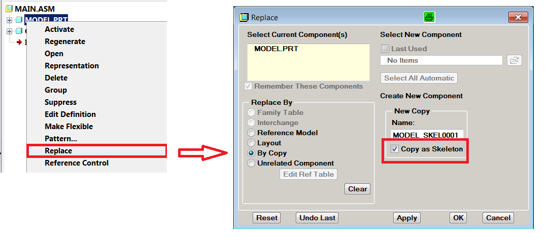

I think that is the problem because you create your skeleton model as "fake model"
Correct steps:
  • Open existing asm
  • Remove all dependencies from Default Datum features
  • Select first model > RMB > Replace >> By Copy > Copy as Skeleton
System will change the model to Skeleton model:
Correct steps:
  • Open existing asm
Vladimir
August 31, 2015
That's a fantastic find.  I discovered that the datum planes need not be deleted, the component just has to be ahead of them in the model tree.  This requires them to be either default assembled or packaged.
If the component isn't first in the tree, the "Copy as Skeleton" option is not present.

September 4, 2015
Hi
in order to keep all references from old master model part to new skeleton part I found this procedure works fine :
1 - I open assembly with standard Master Model (master.prt)
2 - I remove references for assembly and I use Default constraint. Then I move this part on top of model tree
3 - I suppress all components of assembly except Master Model
4 - I "Erase not displayed" all components in memory
5 - I open the original Master model and I rename it ( in session) with new name ( > master_temp)
6 - I manually rename ( directly on disk ) the original master model ( > master_old )
7 - In model tree I select the first component ( now the name is master_temp) and I replace it (by copy , copy as skeleton ) writing the name of new copy model like the original name of master model (master )
8 - I manually rename ( directly on disk ) the master model (master_old) back to the original name (master)
9 - I finally resume all the components of assembly.
That works fine because all logical references based on Copy Geometry features are saved !!
Of course it's important to repeat this procedure with all assemblies .
Bye
Pier
