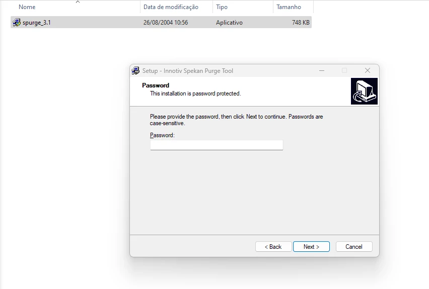

MS_Santos15-MoonstoneAuthor
October 7, 2024
I would like to install the program, is there any solution or version that does not have an installation password?
KenFarley
KenFarley21-Topaz IIAnswer
October 7, 2024
Since the tool you are looking for is not a PTC product, they will not be liable to help you.
If you look at the sidebar of these posts on the right side of the screen, called "Recommendations" in the English layout, you will see that there have been a number of questions similar or identical to yours. Here's the top one:
https://community.ptc.com/t5/System-Administration/Spekan-Purge-3-3/m-p/142144#M3943
