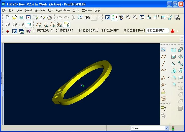

    We are using WF4, and ALT-TAB will cycle through the open ProEwindows, but it will not activate the window you choose.
    An option that might help, though, is to add the (List of Current Windows) option to your menubar. This will allow you to not only change to another window with one click, but it will activate the window you choose. It took me a little while to get used to using it, but once I did, I like that I am one click from any open window. Thelist can be shown in the top menubar or on the side menubar. To add it, do the following:
    <u>To Show a List of Current Windows:
    </u>
    Tools >> Customize Screen...
    Under Categories, Scroll down and pick All Commands. (It will take a few moments for all the commands to load.)
    On right side, click and drag (List of Current Windows) to your menu bar. This item can be located on the top or side of your screen.
    I have included a screen imageshowing six open documents. It is easy to see what is open,and I am only one clickaway from any of them.
