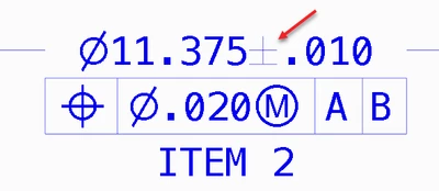

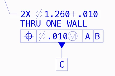

  • When trying to convert an existing drawing to true type fonts, I can get all the symbols to update to the new font by modifying the parts and assembly files, except for the plus minus symbol.
    • Does anyone have a method to update this symbol on an existing drawing?davehaigh_0-1602707327808.png
    • The strange thing is, If you create a new drawing, then this symbol displays in the true type font.
      • Obviously creating a new drawing is a non-starter when revising existing drawings!

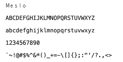

  • Can anyone suggest good mono spaced True Type font?
    • We have been considering two fonts:
      • Meslo Font
      • Consola that you will find here on your windows machine: C:\Windows\Fonts\Consolas
  • I’m assuming unlike a stroked font, you can’t change the height to width ratio of a True Type Font. Is that true or not?

For example I have an assy of two parts that is a weldment. All of these files have to change to use True Type Fonts in the drawing. I would have expected the change in the drawing would have been all that was necessary. That fact that the display in the drawing is linked to the display in the models is a problem. At least the way I think about this it's a problem.

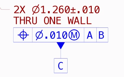

If I go into the drawing detail setup file and modify the default_annotation_font to a .ttf font, and the symbol_font to asme, I get these results.
Notice that the,
  • diameter symbols,
  • the MMC modifier, and
  • the plus minus are still stroked.
I have to open up the model that dimension was shown from, and modify the detail setup file to show the .ttf font and symbol_font as asme.

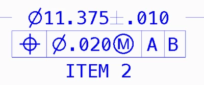

Which results in all but the plus minus symbol showing correctly in the drawing.
However if I look at a dimension that was shown from the other part in the weldment, it’s still messed up.
I have to go modify that part’s detail setup file also, after which I get this. But I know of no way to get the Plus Minus symbol to update to the True Type Font. GRRRRR!

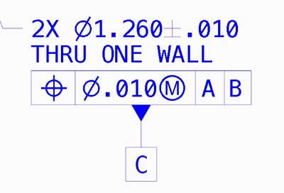

If I create a new drawing and show that dimension, then it shows the Plus Minus in the .ttf font.
So instead of just changing the settings in the model, I have to change the settings, in this case. on 2 parts, 1 assy, and the drawing assuming there is a workaround for the Plus Minus Symbol. If not then I have to create a new the drawing in order to get that symbol to change to a True Type Font.

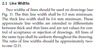

The font is thicker in a print than the stroked font. We make drawing books to take out to our assembly facility during the assembly of experiments. An “E” size drawing on an “A” size page is still legible using the stroked font, This allows the techs and engineer to refer to the drawings while going through the steps of the assembly procedure. True Type Fonts are thicker by far when printed so that the legibility of the print is severely compromised. Again a non-starter unless a better True Type Font can be found.

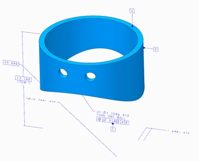

MBE Considerations

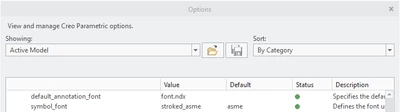

My next consideration was why not change the MBE annotations to use the standard font instead of the default win_font.ndx, have it use font.ndx
So I change the default_annotation_font to font.ndx and the symbol_font to stroked_asme.
And that works. The model dimensions shown as annotations show in the same font as we’ve used for drawings all these years. To me this is a viable option that keeps the font the same in drawings and MBE.
So my question is…
  • Will this font present a problem for down stream applications reading the model. Either with the native model, or a derivative step file.

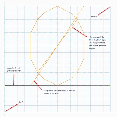

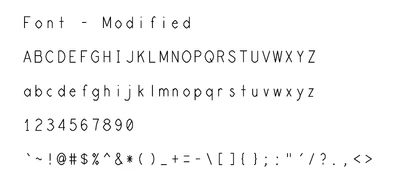

We have not had to modify this font for quit a long time, so I’m one of the few people that remembers how to do this. We have had a discussion lately regarding the slash in the zero.
As it is now, the slash extends beyond the outline of the zero.
But since the True Type Fonts with the slash don’t extend past the out outline, that was one reason some folks wanted to dump this font for the True Type Fonts.

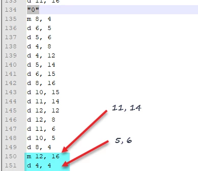

The thing is this is a simple modification.
If you look at the source file for standard font you will see that is defined as 16 x 16 with a base line at 4.
In our standard font, this is what the definition for the zero looks like on the 16x16 grid. I’m showing both the existing slash that extends beyond the outline, and a slash that stays inside the outline.
The font could easily be update by changing of these two lines in the source and then recompiling the source.

Editing the font file:
  • Do a find in the editor, look for “0” This will find the character your looking for.
  • Best if you map out the character points on graph paper or in Creo as shown above.
  • Once you figure out what points to change in the definition as shown above, make those changes in the source file.

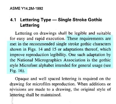

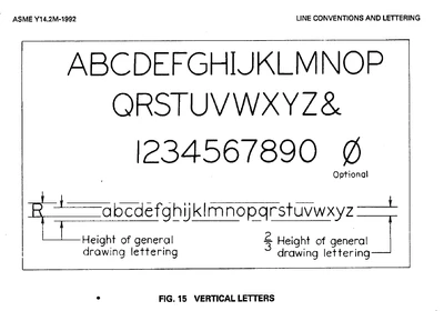

Standards – What they say about drawing fonts
The following is what the standard have to say about fonts on drawings. The standard shows the Zero with the slash as extending past the outline of the zero. Which I’d forgotten when I created the graph image above.
However the true type fonts with the slash in the zero, keep the slash inside the outline.
I believe the slash inside is the better look, but if you want to be a stickler about the standard that is wrong unless there is an update to the standard I’m not aware of.
The two modified stroked fonts are attached. One with the slash inside and one with it outside. The other characters I and 1 are also modified.

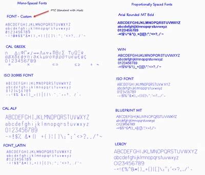

Why we want a Mono-Spaced Font

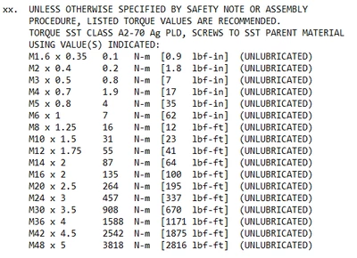

We want tables of numbers to line up. Think of a spline defined by points to a very high precision. A cam would be a good example.
We also have notes like this where we want this information to be in columns for easy readability.
Currently the only mono-spaced fonts PTC supplies are stroked fonts. As shown in the left column below.
PTC doesn’t offer any mono spaced True Type Fonts.
This site lists some of the available Mono-Spaced True Type Fonts
https://en.wikipedia.org/wiki/List_of_monospaced_typefaces
We want a font that has the slash in the zero.
This is a sub set of Mono Spaced Fonts with slashed zero

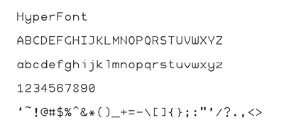

Our Standard Stroked font – PDF output from Creo

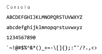

Hyper Font – PDF output from Creo – I like this because it’s not much thicker than the current font. I thing there is some weirdness in the 8 where it thins down too much in the middle. Same issue on the upper case N.
Meslo – A windows version of the Menlo font – PDF output from Creo – Too my eye this is too bold.
Consola – Standard Windows Font – PDF output from Creo – Same issue, this is too bold. Also the lower case italic i & j look weird, although I don’t recall ever using italic on a drawing.

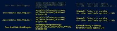

11-Garnet
Mar 12, 2021 5:47 PM UTC
Dave,
Checkout Incosolata. Inconsolata-Regular.ttf matches font.ndx almost exactly.
Pro's:
  • Monspaced
  • Matches Creo's default font.ndx (.8 width ratio) almost perfectly
  • All unique characters
  • Comes in 8 different line weights & 9 different width proportions.
  • Open source so the lowercase "g" problem below could be rectified with the right resources.
Con's:
  • Closed tail lowercase "g"
Inconsolata also comes as a "family" font file that supports variable width & weight for when PTC decides to support these TTF features.
18-Opal
Mar 15, 2021 4:16 PM UTC
@BrianSnyder, this is very useful, thank you for posting!
I did some tests and it is very close to Creo's font.ndx while being a real font where we can bold, etc.  It is not quite as clear as something like Arial, however, it is better than the stroked Creo font.  I also like how it is monospaced and all letters and numbers are differentiable and unique shapes (no Ll1Ii confusion).
In the 3rd column the world "Consult" is bolded in all (except of course the Creo font.ndx because Creo won't let me control/change letter thickness of stroked fonts! Grr!)
I have no idea why but the inconsolata font cannot switch between bold and regular using the shortcut key whereas Ligconsolata (also included in the zip file) can switch between bold.  I even tried renaming the font to the way other fonts are named and restarting Creo and that didn't work.  It requires the user to manually change font style.
We would have to do quite a bit more testing of course but this might eventually help us switch.

NOTE:  All of these mapkeys below are what I would consider experimental as I've only recently begun the trip down Creo's ttf lane.
Interesting anomaly about the mapkeys issue.  Because Creo 7.0 has graphical slowdown when using TrueType fonts I created mapkeys to switch between ttf & stroked.  Maybe you can compare and modify mine to work for you.
mapkey ttf @MAPKEY_LABELTrueType Font;\
mapkey(continued) ~ Command `ProCmdDwgProperties` ;\
mapkey(continued) ~ Activate `mdlprops_dlg` `OPTIONS_lay_Controls.push_Change.lay_instance`;\
mapkey(continued) ~ Input `preferences` `InputOpt` `default_annotation_font`;\
mapkey(continued) ~ Input `preferences` `EditPanel` `inconsolata-regular.ttf`;\
mapkey(continued) ~ Activate `preferences` `AddOpt`;\
mapkey(continued) ~ Input `preferences` `InputOpt` `symbol_font`;\
mapkey(continued) ~ Input `preferences` `EditPanel` `asme`;\
mapkey(continued) ~ Activate `preferences` `ok`;\
mapkey(continued) ~ Activate `mdlprops_dlg` `DlgClose_push`;
mapkey ttr @MAPKEY_LABELStroke Font;\
mapkey(continued) ~ Input `preferences` `EditPanel` `font.ndx`;\
A mapkey to open the active drawing model and change the symbol font to asme (ttf).
mapkey fixmdlttf @MAPKEY_LABELFix MDL TTF;\
mapkey(continued) ~ Select `main_dlg_cur` `PHTLeft.AssyTree` 1 `node0`;\
mapkey(continued) ~ Open `main_dlg_cur` `PM_PHTLeft.AssyTree`;\
mapkey(continued) ~ Command `ProCmdOpenModel@PopupMenuTree`;\
mapkey(continued) ~ Activate `open_instance` `open`;\
mapkey(continued) ~ Command `ProCmdMmModelProperties` ;\
mapkey(continued) ~ Activate `mdlprops_dlg` `DlgClose_push`;\
mapkey(continued) ~ Command `ProCmdWinCloseGroup`;\
mapkey(continued) @MANUAL_PAUSEModel should now use TTF symbol fonts.;
