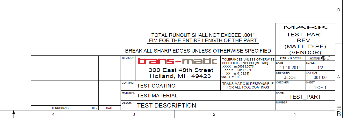

Curious if anyone is willing to share a picture of their titleblock. I am working on a redesign of ours and would like some fresh ideas. I feel like more and more stuff keeps getting crammed into it.
For reference, here is our current "B" size format (for individual parts)

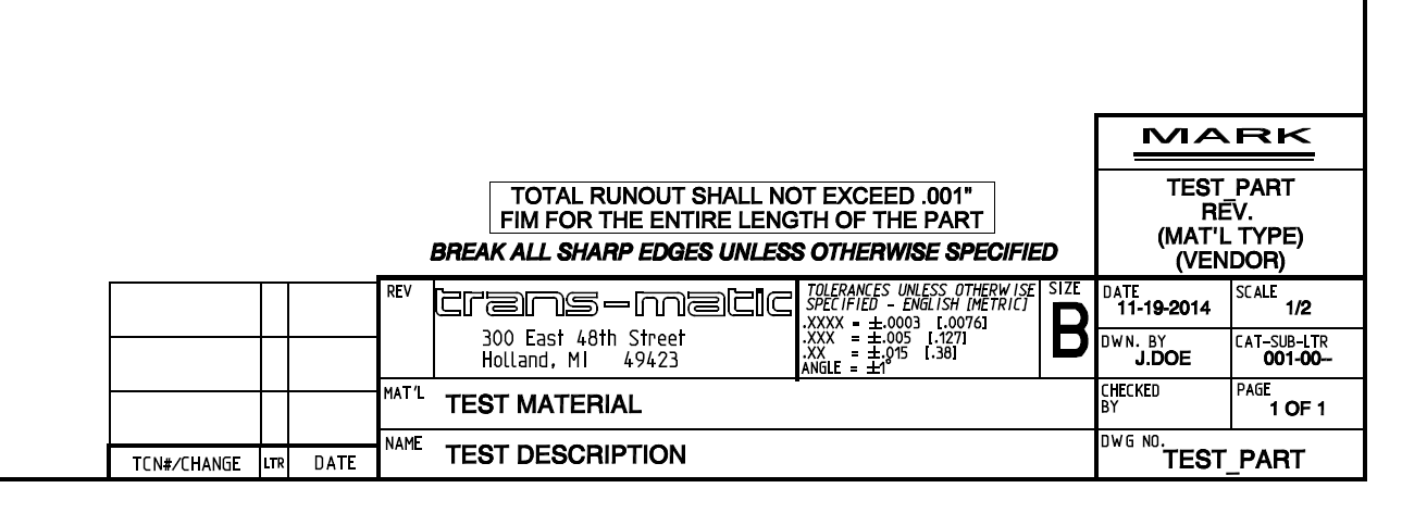

And here is the new version (still in development).

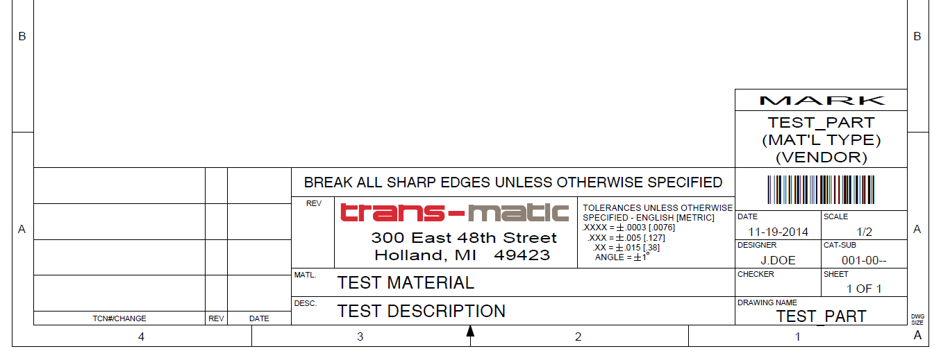

Unfortunately I now need to add a barcode as well. Here is a simplified "A" size with that.

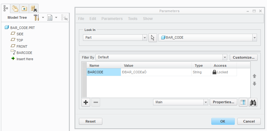

I am currently atempting to create a barcode on a drawing. I am trying two fonts that others on the forum have said were functional code 128.ttf and code 39 30.ttf. One font works in Microsoft Word the other does not. If you have gotten your title blocks to work successfully could you offer some guidance.

I'm using "code128.ttf". (Attached) You just copy it to your fonts directory and you're good to go. This works fine in both Word and Creo.
Keep in mind that code 128 requires a start character, an end character, and a checksum character. My approach was to create a top level parameter in the model named "barcode" and then add feature relations via a UDF (annotation feature) to calculate the proper values based on the model's name. (See picture and attached UDF.)
To use this on a drawing, I simply display the parameter value (&barcode) and set the font to code128.
Be careful when printing. If you make it too small the scanner won't be able to read it. Using stroked fonts vs. TrueType fonts when printing as well as pen table values can have a big impact on the scan-ability. I settled on .25" high.
