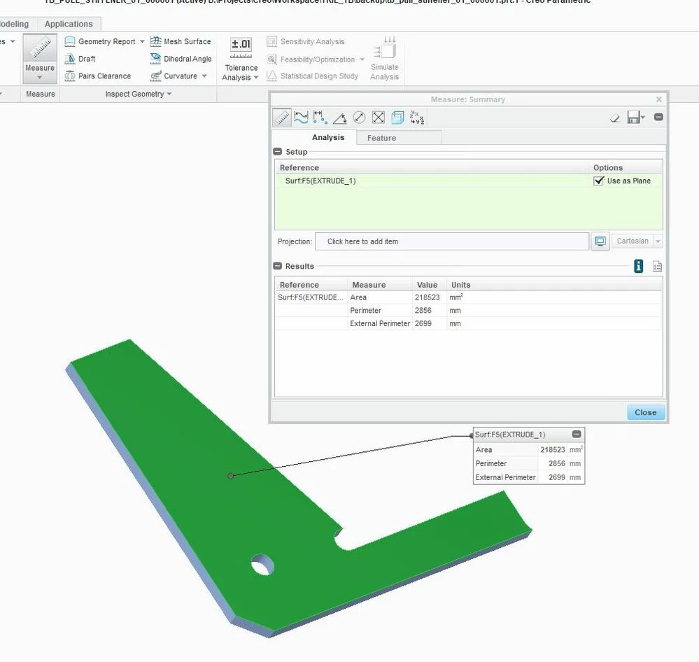

You can use the measure tool. Measure the surface area and then look at the summary of results ...

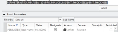

This is what we use to calculate the perimeter (including cut extrudes) of formed parts. Running Creo 7.0.7.0
1. Add relation to Sheetmetal Start Models.
PERIMETER=(PRO_MP_AREA - (2*(PRO_MP_VOLUME/SMT_THICKNESS)))/SMT_THICKNESS
2. Mapkey that saves mass properties and regenerates the model to update the Perimeter Value..
mapkey ww @MAPKEY_LABELMass Prop Calc / Regen;\
mapkey(continued) ~ Close `main_dlg_cur` `appl_casc`;~ Command `ProCmdMmModelProperties` ;\
mapkey(continued) ~ Activate `mdlprops_dlg` `MASS_PROPS_lay_Controls.push_Change.lay_instance`;\
mapkey(continued) ~ Activate `mass_prop_dlg` `CalculateMPPush`;\
mapkey(continued) ~ Activate `mass_prop_dlg` `OkPush`;\
mapkey(continued) ~ Activate `mdlprops_dlg` `DlgClose_push`;\
mapkey(continued) ~ Command `ProCmdEnableAutoRegen` 1;~ Command `ProCmdEnableAutoRegen` 0;\
mapkey(continued) ~ Command `ProCmdRegenPart`;
