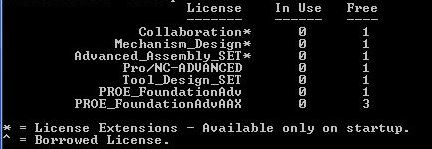

Hello all, I've been away for a bit.  I just started a new job and had some time off in between.
Anyway, the new place has what looks like 4 licenses, but they are old packages and I'm trying to get an handle on what they are.  Here's what PTC Status tells me::
So, 3 foundation advantage with AAX and one without.
A floating Pro/NC and Tool Design.  I assume those can be loaded as needed, after Creo is launched (although they aren't used often anymore).
What I'm not certain of is  the "Collaboration" extension.  Looking here at PTC.com, it looks like there are several to allow working with Catia, NX or SW data. How can I determine which one we have?
I assume that "Mechanism Design" is MDO where I can simulate forces and apply friction, correct?
Also, I should pair the "Advanced_Assembly_SET" with my non-AAX seat to give it the same functionality, right?

Doug,
PROE_FoundationAdvAAX = PROE_FoundationAdv+Mechanism Design+Advanced_Assembly_SET
PROE_FoundationAdv+Mechanism Design = one order item (this means Mechanism Design is coupled with PROE_FoundationAdv)
Design Collaboration (code 210 ?) is probably old module, which is "dead now" (this is my guess), see Pro/ENGINEER Design Collaboration : Speed Consulting
MH

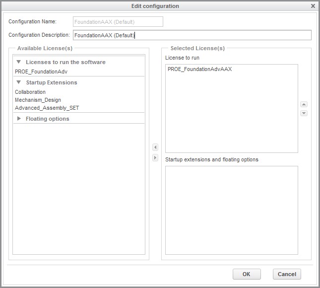

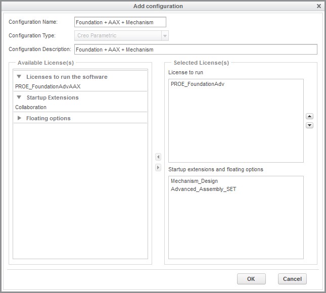

September 29, 2016
So, these two configurations should be functionally equal:
That makes sense on the "Collaboration" extension. They haven't reconfigured their seats in a long time.
Is the "Mechanism Design" the full MDO with forces, friction, etc. or not?

Doug,
to be sure you can compare module codes in case of "two configurations".
Mechanism Design is not MDO, it is MDX - you can assemble components using mechanism constraints and simulate mechanism motion (probably with collision detection), only.
