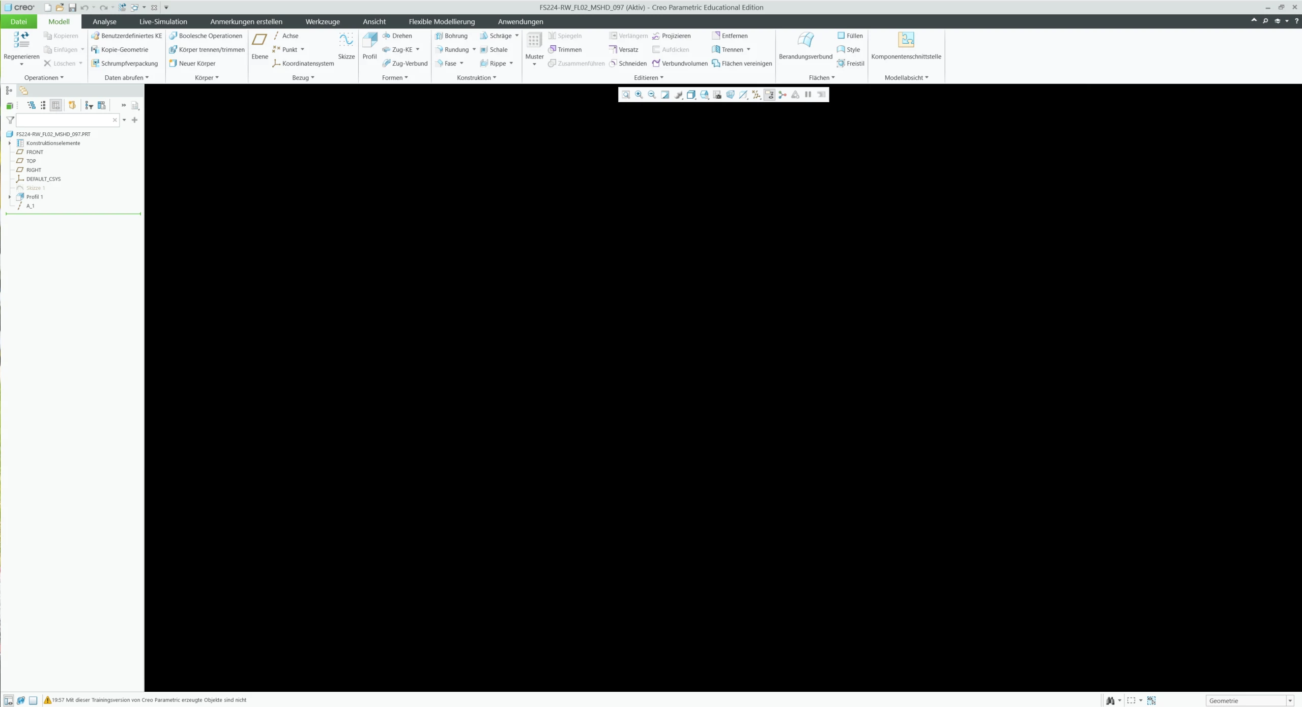

when I open the program I just see a black screen
I have installed Creo Parametric 11.0 on my laptop (RTX4060 and  intel i5). now when I open the program I just see a black screen. I have already done an update of my graphic card driver, but that did not help. If anyone knows how to resolve this issue, I would be glad if you could let me know.

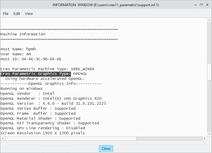

please click File > Help > System Information > System Information.
Then scroll window contents until you see Creo Parametric Graphics Type:
It must be set to win32_gdi
In my case it is set to OPENGL (because my graphic card is accepted by Creo)
