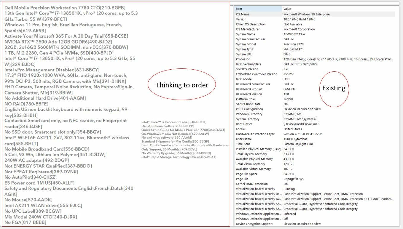

For CREO 11, to run like a butter, which one is the choice? Can you please suggest. Thanks.
I do lot of rendering and work on huge assemblies. Military Aircrafts.
My work is not stuck with what I have but I want to only go ahead if there is a quantum difference. I do not want to regret the buy! See Image for existing and thinking to buy specifications.

CPU's are similar with the new one having a slightly higher turbp clock speed.  Extra cores don't do much for program performance.
Any real gain would come from the GPU, for rendering the models, and I don't see your current GPU in the image.
kdirth
What is your current GPU?
If it's in the budget, you may want to upgrade the GPU and add more RAM for the size of your assemblies.
StephenW
Other than what @kdirth mentioned, It looks like your current computer has 64gb of ram and you proposed new has 32.
You may be okay with that, based on your assemblies but you may not!
When you get your new one, do a benchmark (www.creosite.com) on your new one and old one, just to give you a good idea of performance improvement.
It doesn't translate directly to your day to day work "speed" but does give you a good feeling about the performance improvements. It also will help to determine if you need to tweak something. You can also look there at the results and see if anyone has uploaded their benchmark on a computer with similar specs as yours.

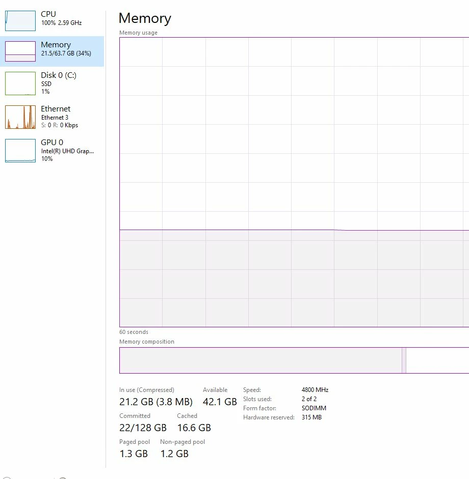

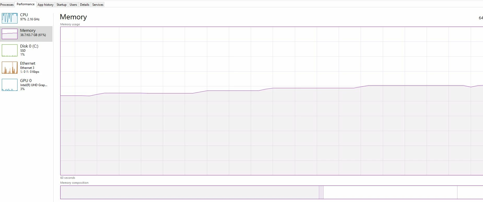

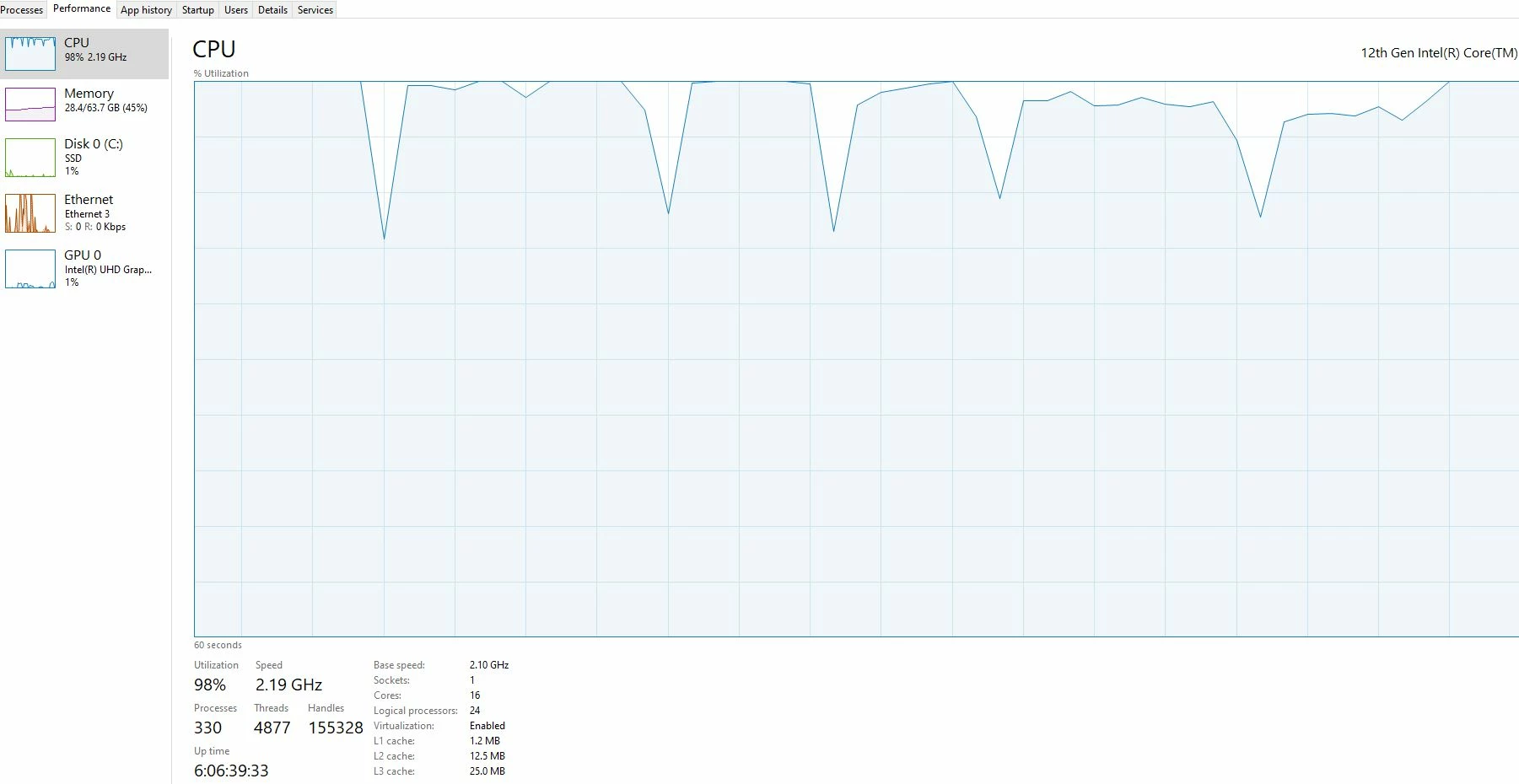

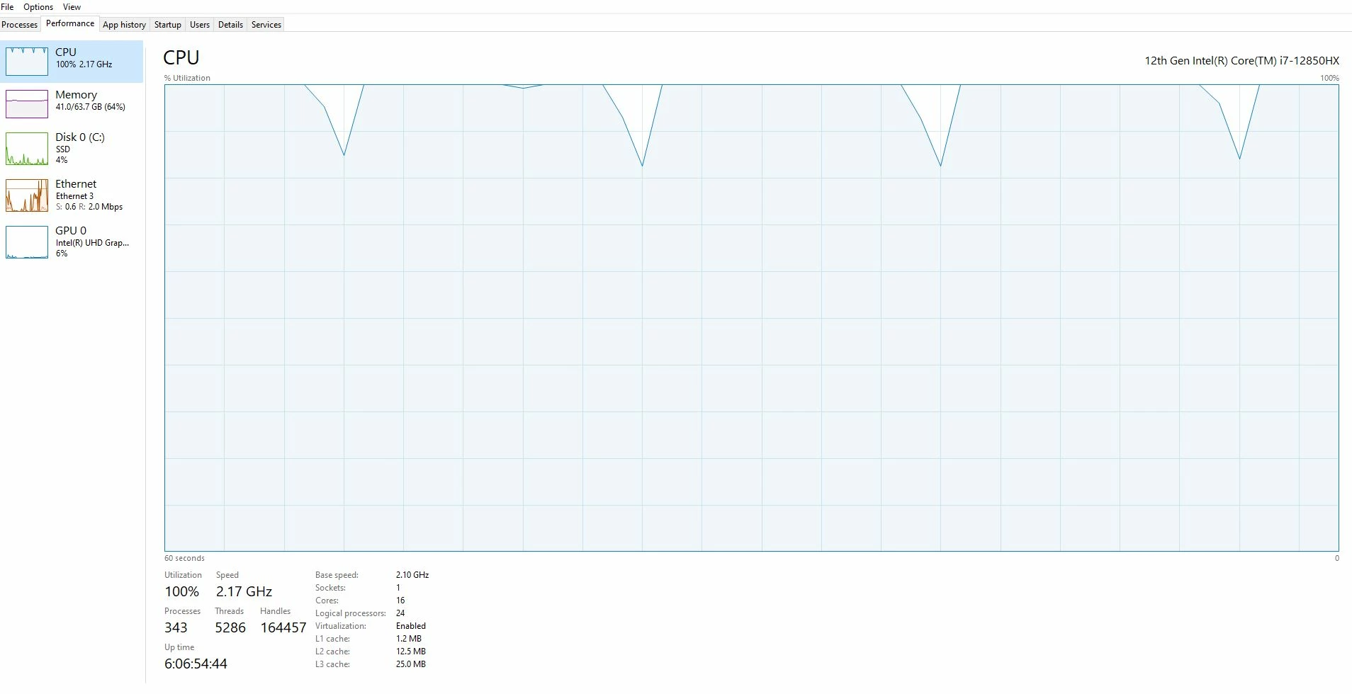

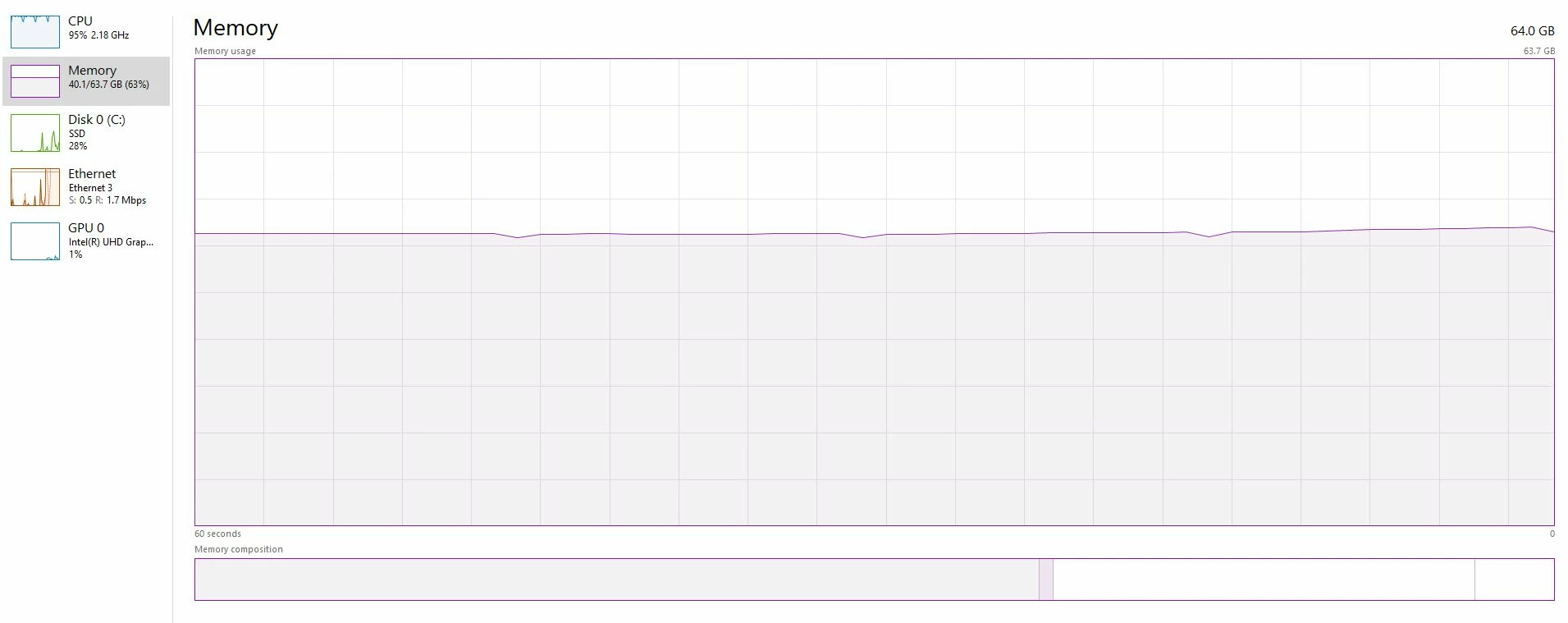

I did some extreme rendering on big assembly and got some data to browse and see what you all think. Pl see images. Random snap of Task Manager performance. What comes up would be interesting to know.
Yogesh
So it looks like the rendering is being done by the CPU and not the GPU.
A desktop CPU is going to be able to significantly out-perform a laptop CPU for less money.
You captured a "Overall utilization", also set the view to "Logical processors" to see whether rendering is using single or multi-core.
Compare CPU performance for single or multi-core depending on above view and spend your money improving that type of performance.
Also, you are using more than 32 GB memory, so make sure you configure with at least 64 GB.
