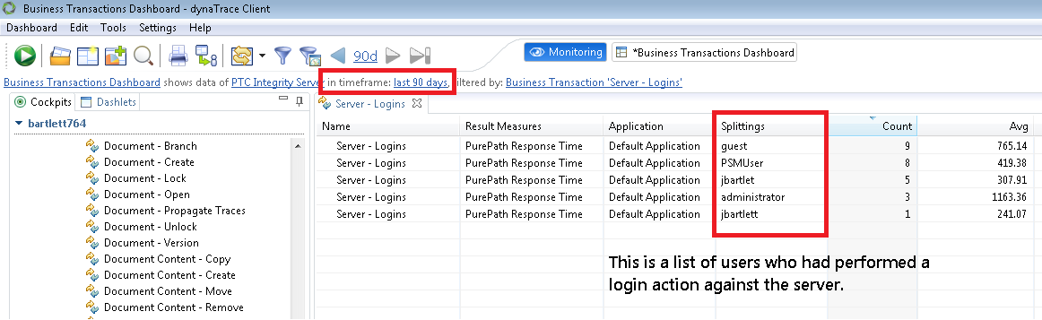

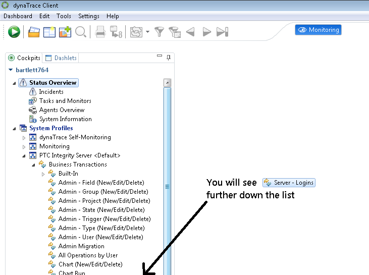

    1) Within PSM, you can expand the left-side cockpit to show the Server - Logins business transactions.
    2) Double-clicking on it will bring up a new tab showing all login operations within the timeframe defined by the filter at the top (last 30 minutes by default). You can click the filter hyperlink and change it to the pre-set Last 90 Days timeframe. Take note that the Splittings column gives a list of the usernames.
    3) You can copy and paste that list directly into Excel.
    4) Next, from the Integrity command line you get a listing of all users in mksdomain which can be redirected to a text file:
    aa users > TextFile1.txt
    This user list can be copied from that file into the same Excel spreadsheet side-by side and sorted. Once they are compared you can see the extra user accounts who did not appear in PSM. These are the users who have not logged into Integrity in the last 90 days and you can inactivate them.
    Hopefully that makes things easier.
