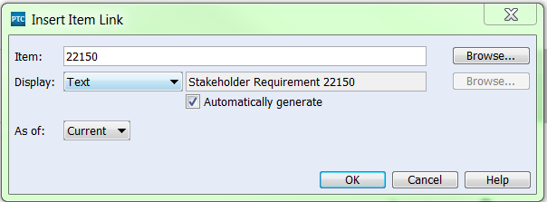

Also, while linking to an Integrity item, you have the option of choosing to "Display Text" and manually entering what you want it to look like.
Unless you manually type the name of the item, it shows the item type and the item ID (ie. System Requirement Document 12345).
Is there any way to change this to automatically show the title of the document or the text of the requirement?

    As far as I know, this is not done via script but a embedded in the client (I don't think the web interface offers that).
    All "automatically generate" does is what you showed here (generate the text as Type + ID) and there's nothing you can customize there.
    The only workaround I can think of would be a trigger that scans the text and replaces the item link with what you want here.

    Sep 25, 2015 4:31 PM UTC
    Unfortunately that's not what I'm referring to..
    Maybe this will help.
    Do you see how the Display Text, when automatically generated, shows the "Type" and "ID" of the item I am trying to insert a link to?
    I would like it to automatically generate other attributes.
    I am assuming that this is done using a script, which means it should be editable to any attribute common among all items.
    It'd be great if you could let me know if this is possible, and if so, please point me in the right direction.
    Users don't want to have to type in the title every time they're linking items, which is a frequent use case.
    I hope that clears it up.
