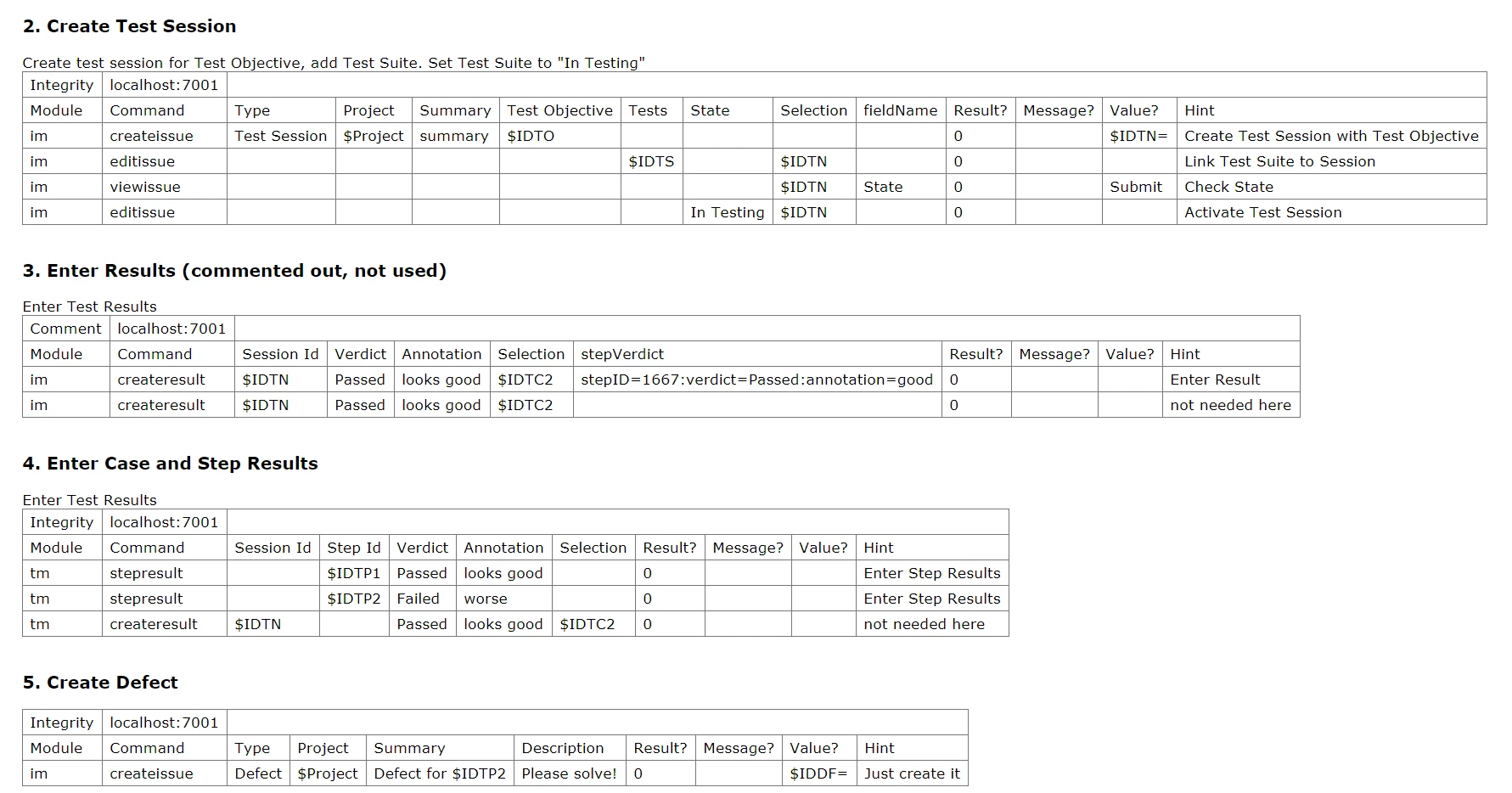

Hi Josef,
I am attaching a set of commands collected in a table for you.
In it you can see in the first line of each table the parameter itself and below the values.
There are different ways to fill test step results.
You just need to turn the tables into the CLI one-line form.
All your questions are answered in the CLI documentation, you have it present?
Hope this helps
Volker
(PS: The tables are from my own Setup Testing Framework, look for the keyword "STeF" in the Integrity Blog).
