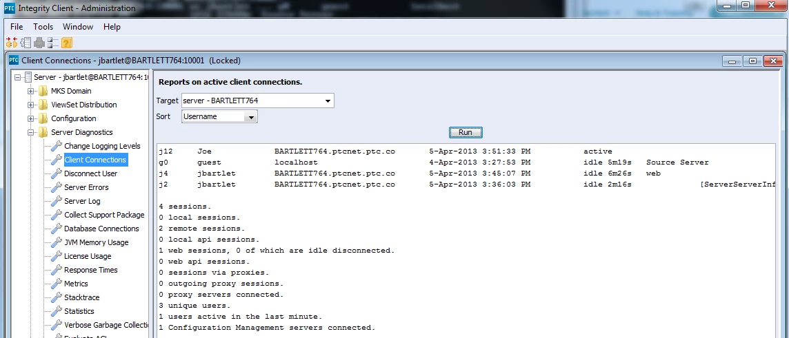

    Sure, as long as you are running Integrity 9.7 (aka 2009 SP7) or later you should be able to see the information about connected users. You can get this from the Administration Client (im admingui) or from the CLI if you are granted the Admin permission. The command would be:
    im diag --diag=connections --hostname=[servername]
    The CLI will give you output similar to the GUI which looks like the attached screenshot.
    Notice that my server has 'jbartlet' connecting both via a regular client and the web (desktop client shows nothing in that column). If there were any API connections they would be denoted with "api" in the line as well.

    Apr 5, 2013 8:23 PM UTC
    Thanks for the info, looks like what I'd like to get but this won't be from an admin connection. I'm using Python to access MKS through the command line interface and most users aren't admins. Is there any other way to know if a GUI session is active, that might be good enough? I can probably ask Windows but asking MKS directly would be easier.
    Eric
    Apr 5, 2013 8:38 PM UTC
    Unfortunately that information is only accessible from Integrity. You could probably get open connections to the server machine from the netstat command but that doesn't really tell you which are Integrity users or how they are connecting.
