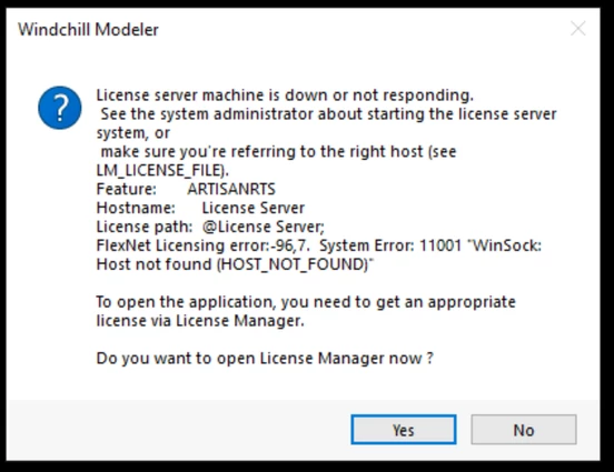

I am suddenly facing an issue on running the Windchill Modeler application and facing the FlexNet Licensing error:-96,7. No changes were made to the Host ID or Host name of the server too.

Hello Aarushi,
Please check the installed license file from License Manager and see if the host name and host id is correct. You can also check the Article - CS345349.
Thanks!
