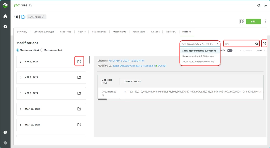

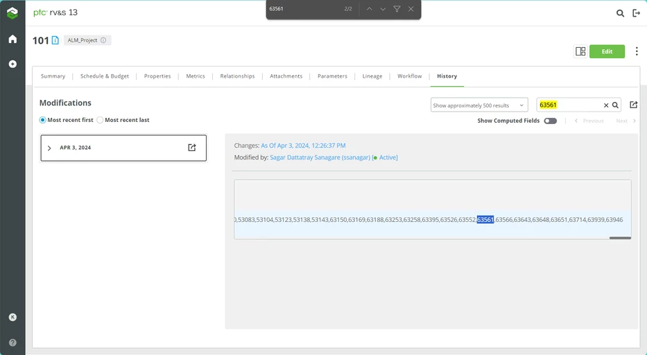

Apr 3, 2024 8:24 AM UTC
            Please refer to the following two screens, these should help you to pull out the information you need. There is a export of all information  on a page, there is an ability to export a specific timeline and there is a Find on Page to help retrieve information.
