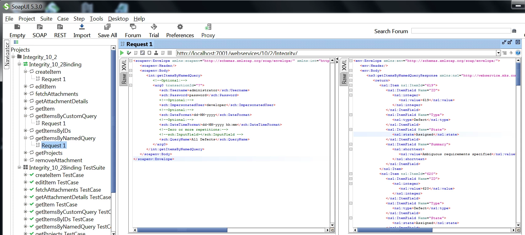

I would suggest that you use SoapUI and import the Integrity wsdl file.
This would allow you to test all WebServices and when done build your own app on top of it.
Attaching herewith a picture:
- in the middle is  the WebService Call for getting All Defects
- the right side of the app displays the result.
The wsdl file that I have imported was this: Integrity_10_2.wsdl. Its usually available from the server.
Furthermore, you can use a wsdl analyser tool to get even more details (if needed).
There is also a documentation available, file name is usually "WebServicesReference_Integrity_10_9.pdf"
