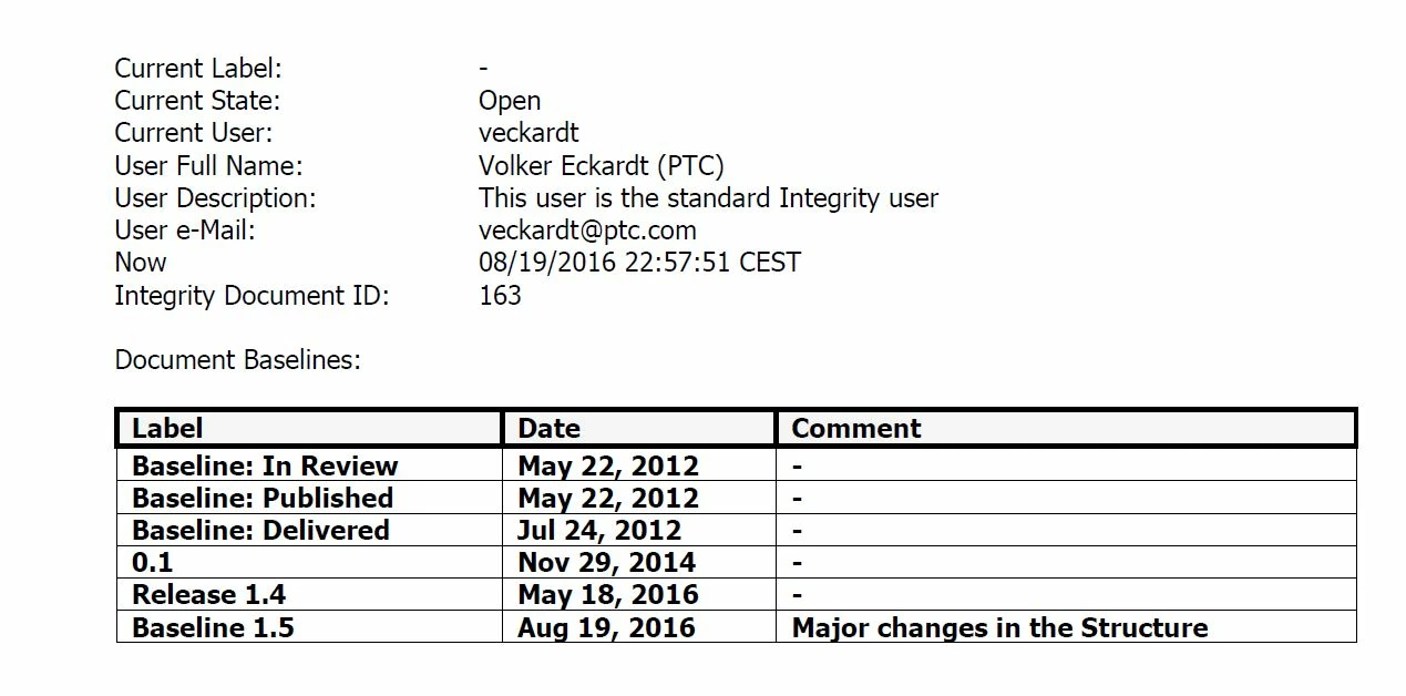

Mar 16, 2018 4:16 PM UTC
Hello Shilpa,
as you already realized, the difficulty with an automatically generated history is that this would become very long. Even the smallest change (like adding a dot at the end of a sentence) will track the whole text entry. In other cases where you add a dot between numbers can change the whole requirement. (when 10 becomes 1.0)
We discussed this topic a lot, but it turned out that a manually added revision comment is the most appropriate solution. (Document > Baseline)
The question is now how to read the Baselines to send them into a Word export: for this you must use my CustomExport functionality which does exactly that. (see attachment)
Alternatively, you can also feed the baseline data into a new rich text field and print this out together with the document. This would need a (server) trigger only.
