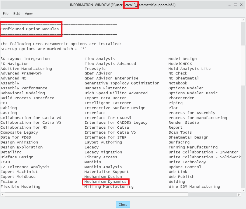

Best answer by MartinHanak
@GS_10978309 wrote:
Due to my company requirements, I am using Creo 9 as well as Creo 10 but in Creo 10 these commands are visible and I can use them but Creo 9 these are not visible here.
in both versions do following:
Click File > Help > System Information > System Information
... and search for Mechanism Dynamics
I guess in Creo 10.0 you will see it -AND- in Creo 9.0 you will not see it.
If I am right then ask your IT to reconfigure startup command in Creo 9.0.

you need Mechanism Dynamics module license to have access to Springs.
