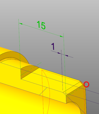

Next, check whether the anchor point of the annotation is on the visible part of a sectioned geometry. The picture below shows the dimension 15. The red circle shows the anchor points pointing to a plane behind the section. In this case the dimension is visible. If these anchor points are cut off by a section, the dimension won't be visible.
