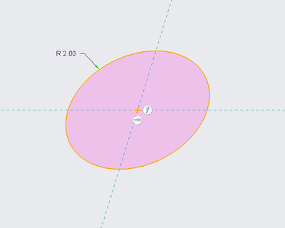

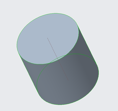

You can. For example I create a sketch of a circle with radius 2 and then extrude it.

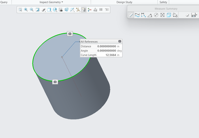

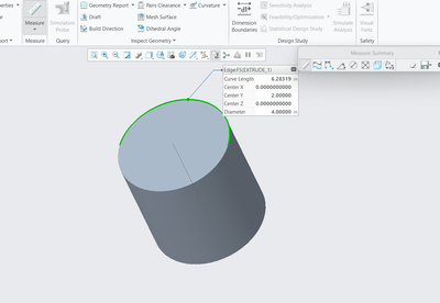

I go to the measure tool and then select the edge of the circular face of the cylinder, this gives me half the circumference.
I hold ctrl and select the other non-selected half edge, this gives me the full circumference.

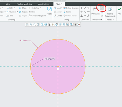

A method that I recently found which might be helpful is defining the perimeter in the sketch itself. I select the perimeter tool, select the circle, click ok in the pop up menu and then select the radius/diameter.

Thank you, yea that makes sense. Seems when you select the edge itself, it will only select half of the circular edge feature. Never understood why it's like that.
