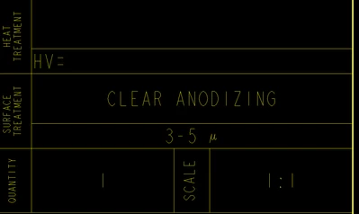

Hi everyone
I was trying to use distributed batch to export form .drw to .pdf.
I faced a problem that this symbol can't show up properly while using distributed batch feature

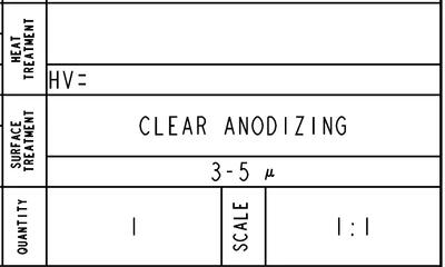

How it looks in .drw
When I export in manually, one by one

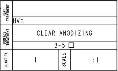

When I try to use distributed batch.
Everything is ok except this one. Glad anyone can help me.
Thanks in advance.

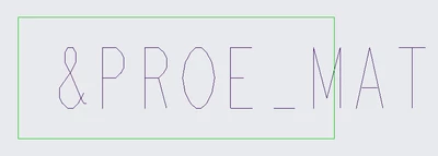

I am sorry I do not have any idea how it is possible that you can see Mu character when you open prt0001.drw.1 drawing. It is possible that your Creo installation is modified in some unusual way.
Please place following note on the drawing. Do you see Mu character or square ?

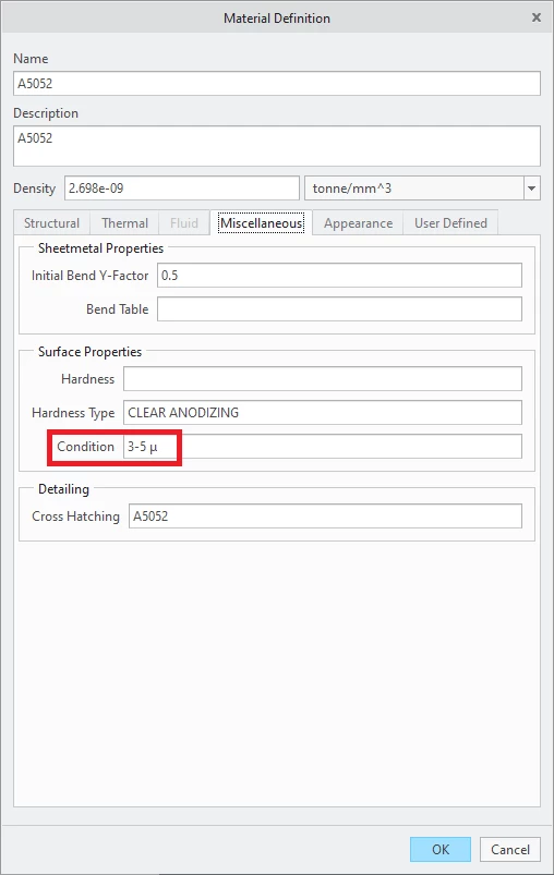

PROE_MAT is model parameter. Its value is defined by model relation PROE_MAT=MATERIAL_PARAM("condition").
condition value is located in material definition saved in model.

INFO ...every Creo installation contains font named font. Unfortunatelly font definition does not contain Mu letter.
Please open Properties dialog box as shown in my video and publish picture of the window. I need to see what font is set in Font field.

it looks like your Creo installation uses modified font named font. -AND- Distributed batch probably uses different Creo installation with OOTB font named font.
Please read carefully following information related to font named font -AND- my Creo installation

just one additional note ... maybe the secret of the problem is related to your personal config.pro file. This file is loaded when you work with Creo interactively -AND- is not loaded when you generate PDF using Distributed batch.
