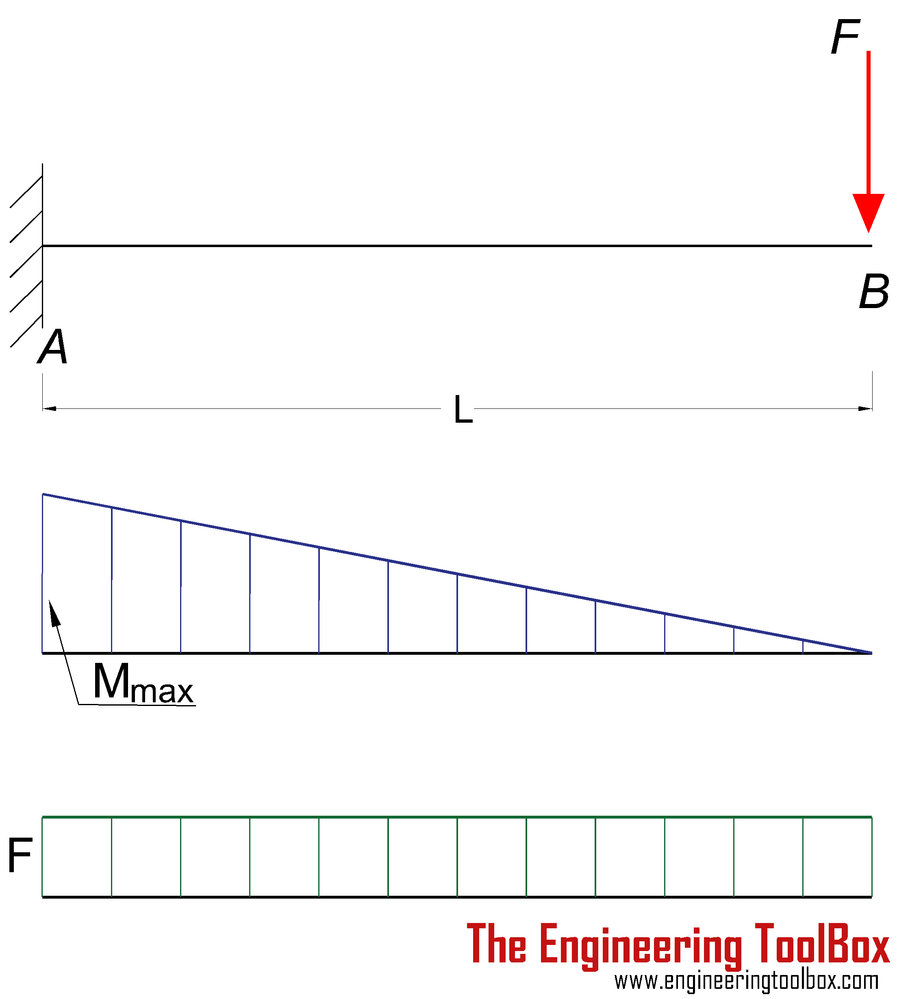

You're very welcome Brian, I'd love to see how that turns out.  I had the idea from looking at cantilevers where it was noted that the beam height at the far end from the fixed end didn't have to be as tall as at the beginning, that the extra material was not helping stiffness.  The isn't the greatest example of what I mean, but I think it gets the point across.
Please keep me in the loop if you do FEA's of both types, I'm dying to know if my theory is correct.  I'd imagine on larger pieces (rocket ring frames, large bilkheads, etc.) the weight savings could be substantial.
