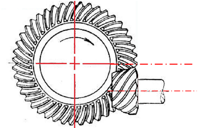

Hi all,
I'm working in Creo Parametric Mechanism to model a pinion and crown gear assembly with axial/radial offset between their axes.
This is not a standard intersecting-bevel gear setup — the pinion and crown gear must mesh with a deliberate offset between their axes.
However, when I attempt to apply the built-in Bevel Gear Connection, Creo throws: "The references for bevel gear connection are not coplanar”.
How can I simulate bevel gear kinematics when the pinion and crown gears are offset (i.e., non-coplanar axes)?

In the case of regular Bevel Gearing, the axes of the cone angles are co-planar. These being spiral bevel gear, perhaps a Virtual Cone angle may be present that makes them co-planar. I guess, one may have to try that route. Just a hunch.
