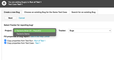

I would like to "Report Bug" in a project different from that of the currently executing Test Run.
When I select Report Bug from a Test Run, the Project dropdown only contains the project in which the Test Run is located. I would like to report the bug in a different project.
I am using CodeBeamer 22.10 SP 4.

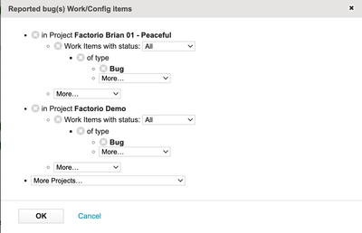

To view additional projects when reporting bugs during a test run, you must first access the test run field configuration page. Once there, click on the 'Work/Config items' link on the 'Reported Bug(s)' field. In the pop-up window, you can add a new project. Be sure to select the 'of type' filter, and then select 'Bug' under the new project, just like you do for the current project. Click OK, then also click Save on the main field configuration page.
Please let me know if this helps or if you have any further questions.
