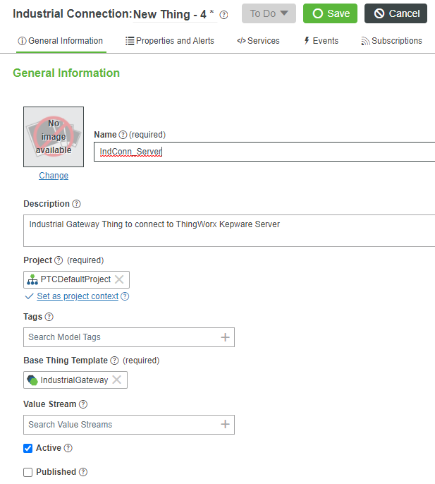

Step 2: Create Gateway
To make a connection between ThingWorx Kepware Server and Foundation Server, you must first create a Thing.
WARNING: To avoid a timeout error, create a Thing in ThingWorx Foundation BEFORE attempting to make the connection in ThingWorx Kepware Server.
  1. In ThingWorx Foundation Composer, click Browse > Modeling -> Things.
  2. Click + NEW.
  3. In the Name field, type IndConn_Server, including matching capitalization.
  4. In the Description field, enter an appropriate description, such as Industrial Gateway Thing to connect to ThingWorx Kepware Server.
  5. If the Project field is not already set, search for and select PTCDefaultProject.
  6. In the Base Thing Template field, search for and select IndustrialGateway.
  7. Click Save.
