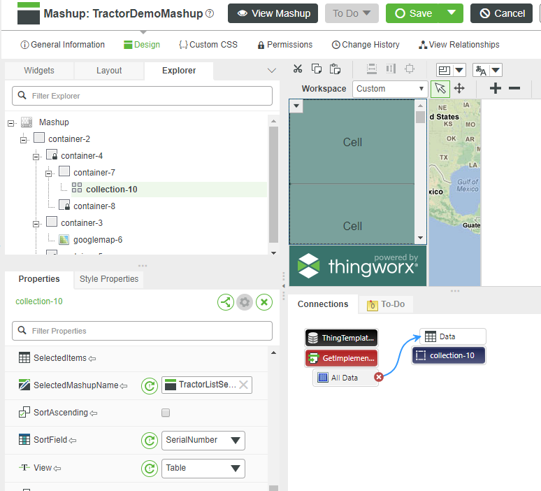

  1. Return to the main Mashup then drag and drop a Collection widget onto the top area of the left side bar.
  2. In the Collection Properties panel, set the View property to Table
  3. Scroll to the Mashup property, click the wand icon and browse to the name of the static Mashup created above.
  4. Drag the All Data source from the data panel on the right onto the Collection widget, then click Data in the Select Binding Target pop-up.
  5. Set UIDField property and SortField to SerialNumber.
  6. Drag the All Data source from the data panel on the right onto the Collection widget, then click Data in the Select Binding Target pop-up.

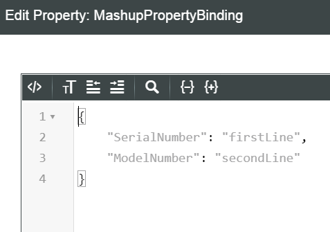

  7. In the Collection Properties panel, scroll to MashupPropertyBinding and click *Add
  8. Enter the text below, then click Done:
     "SerialNumber": "firstLine",
     "ModelNumber": "secondLine"
    NOTE: This JSON property binds the SerialNumber and ModelNumber properties in the data source to the the firstLine and secondLine parameters in the embedded mashup
9. Save the Mashup and click View Mashup.
10. Test the Mashup and you will see the navigation panel on the left is showing data and is linked to the Google Map widget in the center.

  15. Open your original Mashup and click on the Collection widget in the Mashuo Builder canvas.
  16. Scroll to the SelectedMashupName Property and click the + to select TractorListSelecteFormat.
  17. Click Save for the Mashup, then View Mashup to see your Mashup with customized icons.
