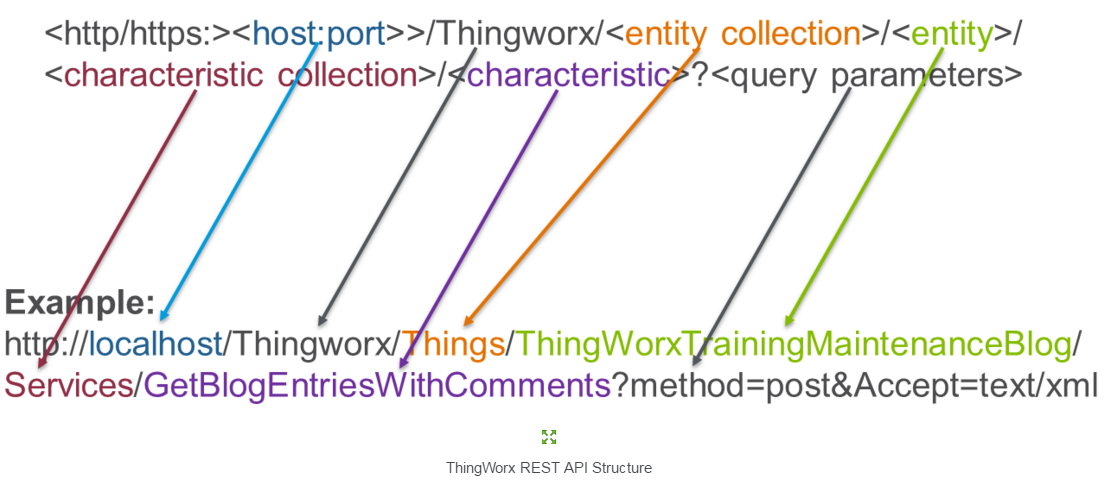

The ThingWorx REST API is entirely accessible via URL using the following syntax:
(Precision LMS. Getting Started With ThingWorx 5.4 (Part 1 of Introduction to ThingWorx 5.4). PTC University. https://precisionlms.ptc.com/viewer/course/en/21332822/page/21332905.)
The above example shows how to access a service called “GetBlogEntriesWithComments” found on the “ThingWorxTrainingMaintenanceBlog” Thing. Notice that even though this service gets XML formatted data, the method is type “POST” and “GET” will not work in this scenario (Further reading: https://support.ptc.com/appserver/cs/view/solution.jsp?n=CS214689&lang=en_US).
