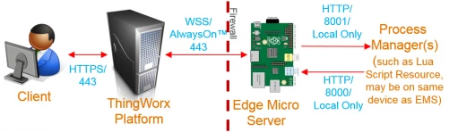

The EMS consists of two distinct components that perform slightly different operations and communicate with each other.
The first is the EMS itself which creates an AlwaysOn™ connection to ThingWorx Foundation. It binds Things to the platform and automatically provides features like file transfer and tunneling.
The second is the Lua Script Resource (LSR). It is used as a scripting language so that you can add Properties, Services, and Events to the Things that you create in the EMS.

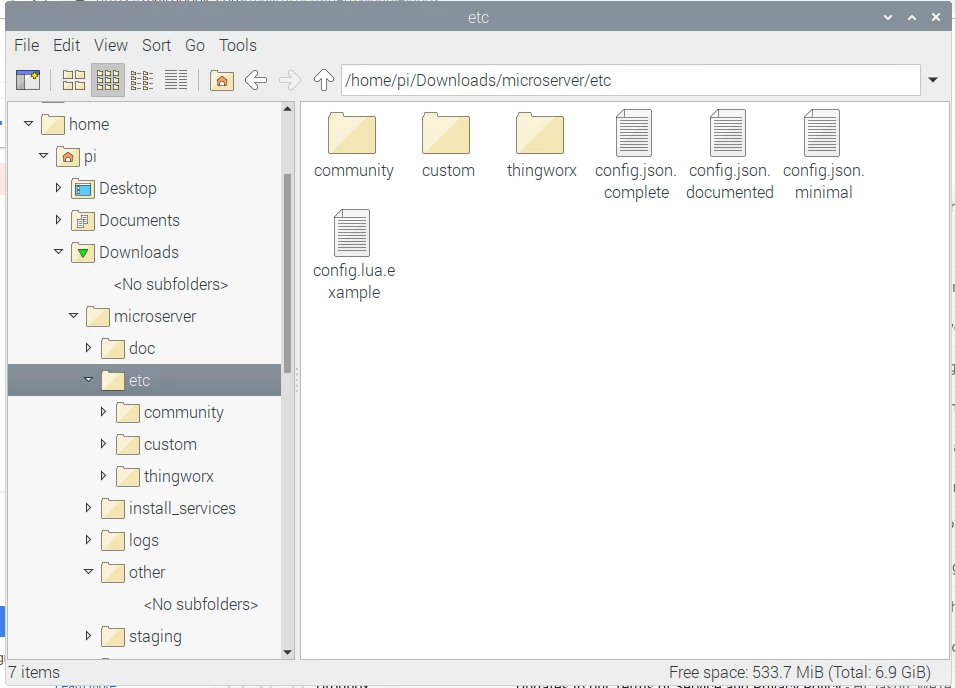

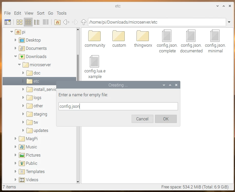

  1. Navigate to the /etc directory.
  2. Right-click inside the folder’s white-space and select New File....
  3. Enter config.json and click OK.
  4. Right-click on the new config.json file and select Text Editor.

TIP: You may have noticed the pre-existing config.json.complete and config.json.minimal files. These are example files that come with the WSEMS and are provided as an aid. The code above which you copied into your own config.json file is simply a customization of these aids. In particular, you may wish to look through the config.json.complete file, as it shows every available option which you might want to configure if you choose to make a custom application with the WSEMS. The config.json.complete file also contains comments for each of these options. However, a functional config.json file may NOT contain comments of any kind, so you would need to remove all comments if you choose to copy/paste some code from that file into a functional config.json of your own making.

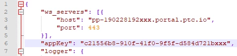

Modify config.json to point to ThingWorx Foundation
  1. Change YOUR_IP_ADDRESS_HERE to the IP address of your hosted ThingWorx instance.
  • You may wish to e-mail yourself the Foundation IP address using a web-mail account so that you can copy/paste on the Pi from your e-mail to the config.json file.
Note that you may use a URL, such as "pp-180207xx36jd.devportal.ptc.io". Either way, the IP or URL must be enclosed in quotation marks (""). Also, Port 443 is the appropriate port for the ThingWorx hosted server. Ports for local-install may vary.
2. Change YOUR_APP_KEY_HERE to an Application Key which you have previously created.
  • Or create a new Application Key now.
  • You may wish to e-mail yourself the Application Key using a web-mail account so that you can copy/paste on the Pi from your e-mail to the config.json file.
3. Save and exit the file.

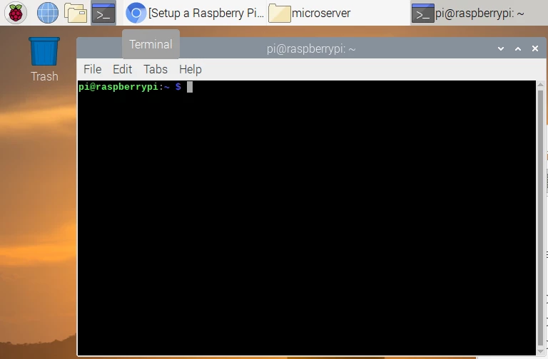

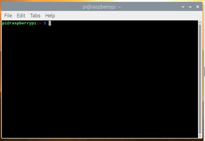

  1. On the Raspberry Pi , open a Terminal by clicking the Terminal icon in the top-left.

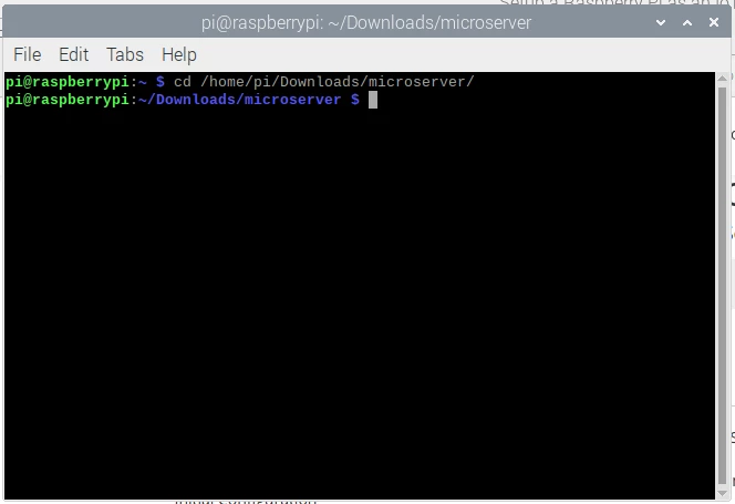

  2. Navigate to the EMS's root folder, i.e. /home/pi/Downloads/microserver , by issuing the following command and then pressing Enter : cd /home/pi/Downloads/microserver

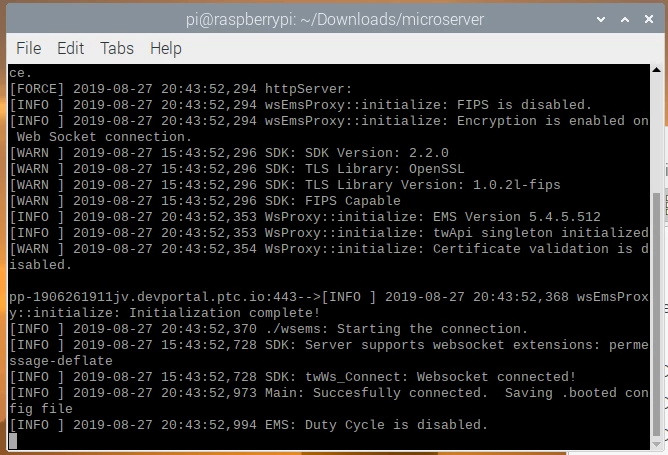

  3. In the Terminal window, enter the command sudo ./wsems and press Enter .
    Note: Do not close this window, or the connection to the ThingWorx platform will close. Also, look through the output in the wsems window. Near the end, you should see Successfully connected. Saving .booted config file . If you do not see the Saving .booted comment, then you likely have an error in your config.json file... especially with either the address or Application Key .

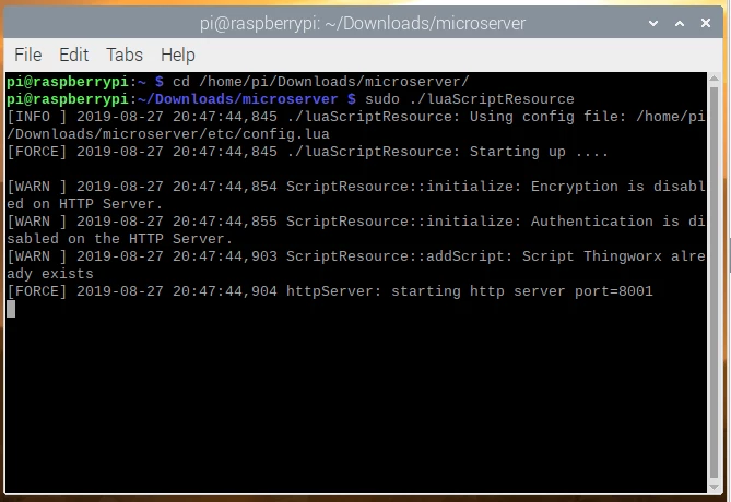

  4. Open another Terminal window as per the above instructions.
  5. In this second Terminal window, Navigate to the EMS's root directory, i.e. /home/pi/Downloads/microserver , by issuing the following command and pressing Enter : cd /home/pi/Downloads/microserver
  6. In the second Terminal window, enter the command sudo ./luaScriptResource and press Enter .
    Note: Do not close this second Terminal window, or the connection to the ThingWorx platform will close.

    : When the scripts start running, the EMS attempts to talk to the ThingWorx platform. However, at this point in the tutorial, ThingWorx does not have detailed information about the Edge device that is attempting to connect to it, so you will see an error message. This is the expected behavior which we will resolve in the next step.
The wsems program runs through the config.json file in order to extract the basic connectivity information to reach the ThingWorx platform. The luaScriptResource program runs through the config.lua file to extract to which Thing the WSEMS should be connecting. Both programs must be running in order to achieve connectivity with ThingWorx.
