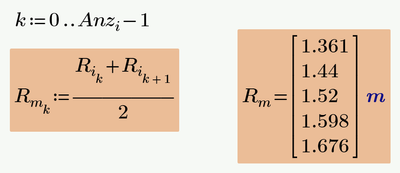

Here is your own approach using a range variable, but as the last element of the vector has no successor, the range to use must run only up to Anz.i-1 and so you can't use i, you need a new range variable - k in my example (but of course you also could redefine i for that purpose).

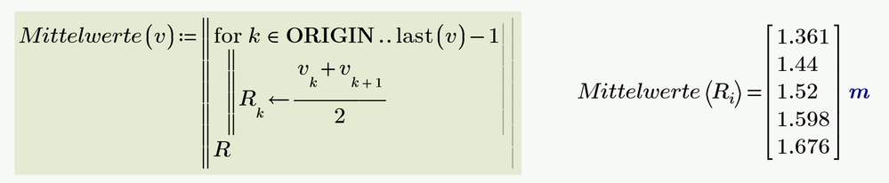

Nonetheless I would prefer defining a small utility function
But is there any shorter and easier Solution for this Problem without Programming?
Luc's "Mean2" function IS quite short (and can be written even a little bit shorter if you assume ORIGIN=0) does NOT use programming (so it could be used in the free Express version of Prime, too).

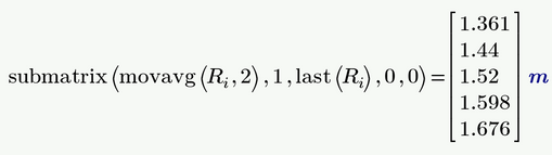

The built-in function "movavg" suggested by Luc makes the same calculations but always returns a vector of the same length by prepending first vector element.
To get rid of it you may use the "submatrix" command
(assuming ORIGIN=0 as is the case in your sheet).

This is one way to do it:
The result for your array is:
There's also a built-in function for it: Moving average. Try:
movavg(Ri,2)
Thanks, the first Example was the Perfect Solution 😎
