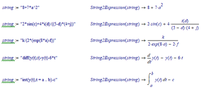

There was a time (and a Mathcad version 11) when, using undocumented tricks it was possible to convert regular mathcad expressions into strings:
and strings into regular Mathcad expressions:
I don't see plans for either on the feature list for Prime 11. The feature may have been submitted in the ideas section (https://community.ptc.com/t5/Mathcad-Ideas/idb-p/PTCMathcadIdeas ) in which case you could vote it up, or else submit it as a suggestion. Then hopefully, before Prime 111 it will be implemented.

It wasn't a feature, but undocumented behaviour, and it wasn't removed, but made inaccessible.
Possibly you can find such functions in Maple or Mathematica. But they would render equations for those applications only, which are not convertible to Mathcad/Prime.
