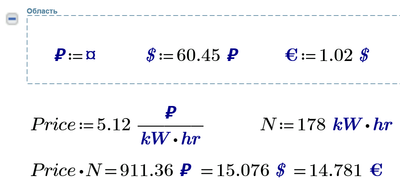

Prime's output always defaults to the base unit, that is 'money' in this case. You can/should replace it with your desired unit:
Also:
(not kW, by default)

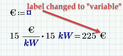

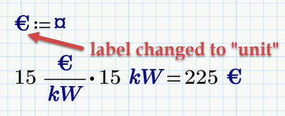

You can change the unit in the result simply by overweriting the unit displayed with the desired unit. If you do this you will get an error ("variable not defined").
This is because you defined the Euro symbol as being a variable (can be seen by its black color).
There are two ways to fix this:
1) Change the label of the currency characer € in the result from the default "Unit" to "Variable" (its color turns from blue to black)
2) The preferred and recommended way: Define € as a unit!
