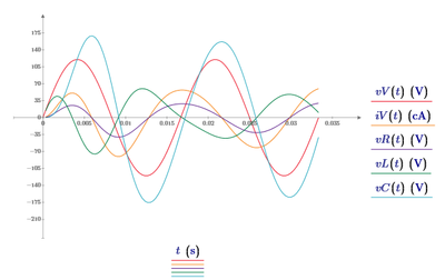

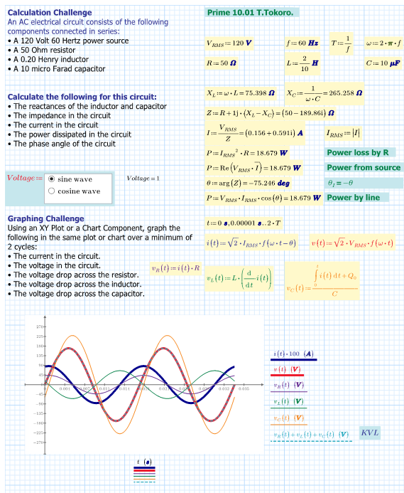

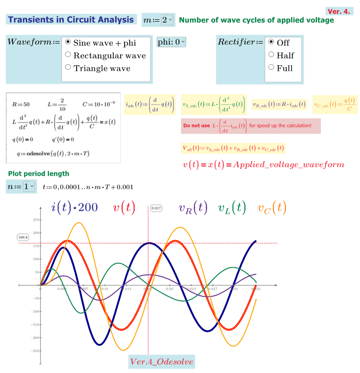

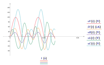

I'm no electrical engineer, but here's how I tackled the challenge:
January 16, 2025
Just noticed that my calculation of the cumulative average, used in the calculation of dissipated power, should have a divisor of k+1, not just k.  This is because Mathcad's origin is 0 not 1.  However, the correction makes no significant difference!
Alan

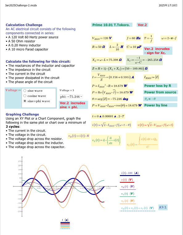

ttokoro

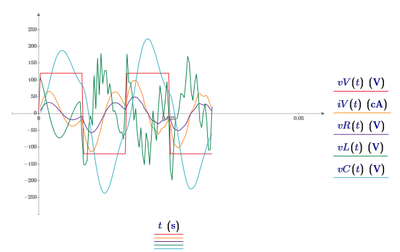

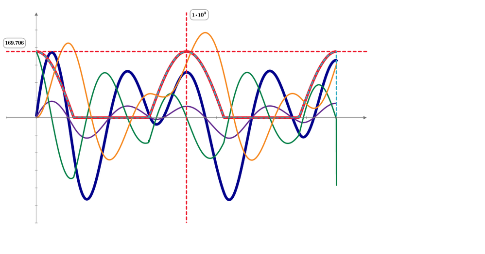

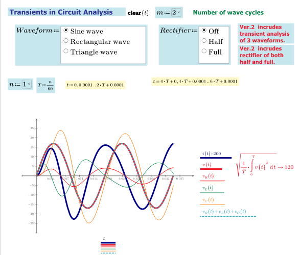

January 18, 2025
1. Add phase shift of sine wave.
2. Add transient responces of 3 waveforms, with all 120VRMS.
3. Add rectifier radio bottuns.
t.t.

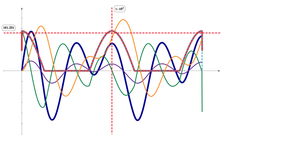

ttokoro

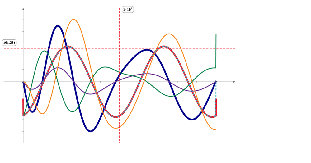

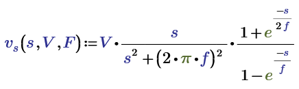

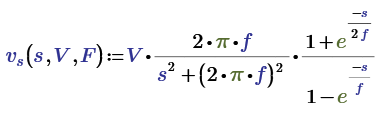

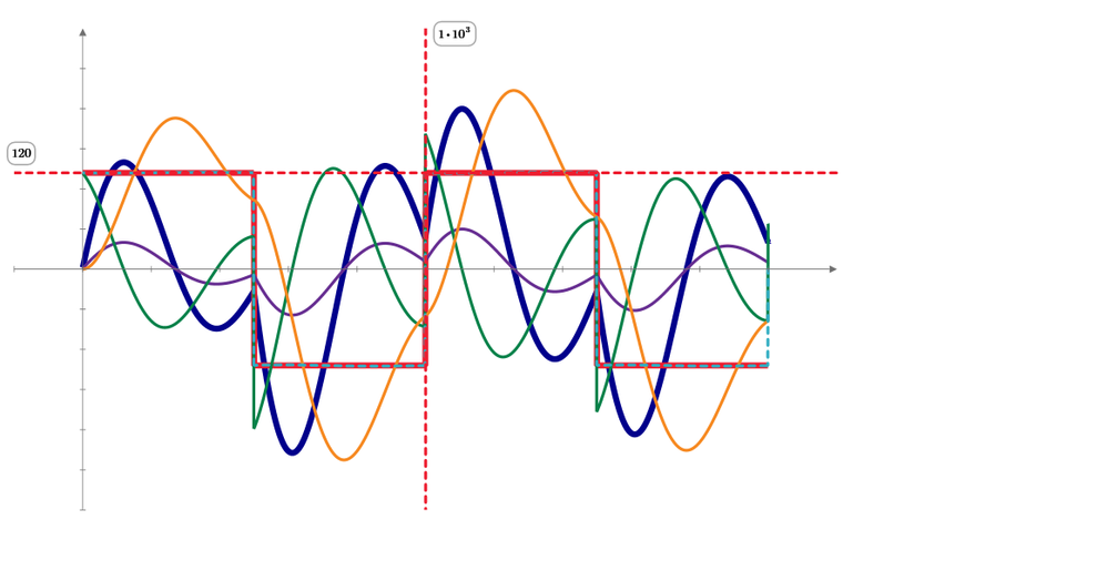

January 19, 2025
Transient responce of sine wave with phi and rectifier can not calculate by Laplace Transform method. So, need more Mathcad  skill to solve it.image.png
t.t.
January 19, 2025
Can be done in express...:

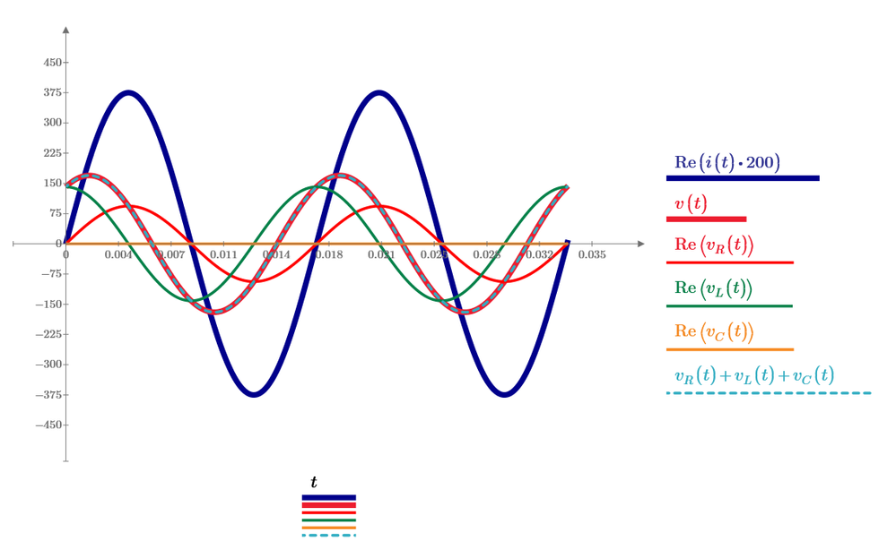

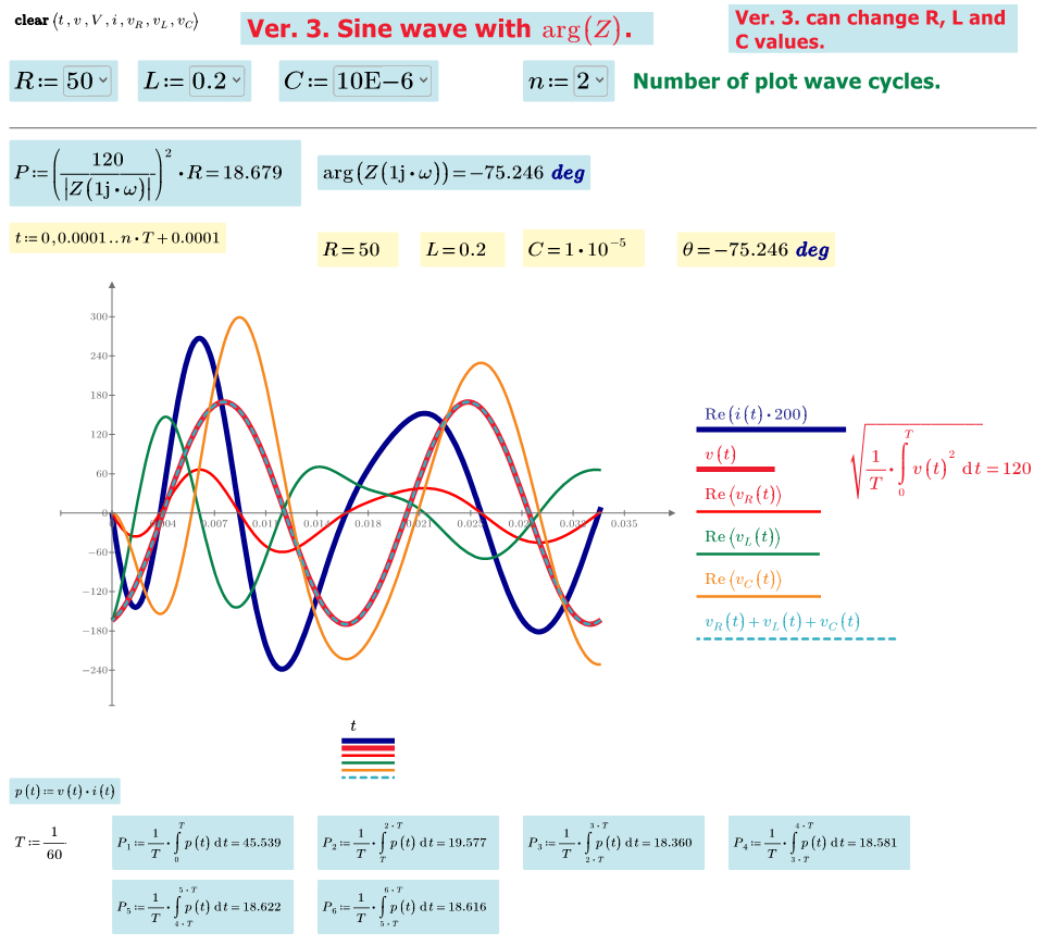

ttokoro
January 22, 2025
Ver. 3 can chage each of R, L, C to short it.  Applied voltage  has angle Z. Therefore, RL circuit can start no transient responce.
You can see RC, RLC or LC circuit's transient responces.
t.t.

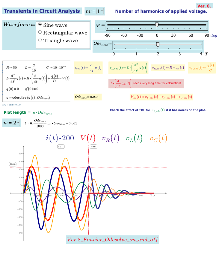

ttokoro
January 23, 2025
Version 4. Solved by using the odesolve of Prime 10.0.1.
t.t.

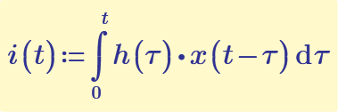

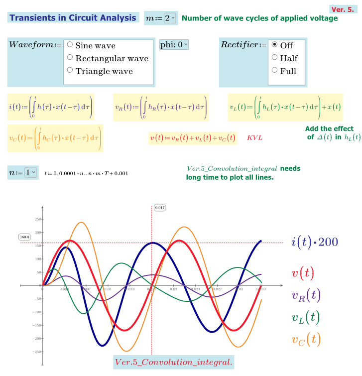

ttokoro
January 25, 2025
Version 5. Solved by using the convolution integral of Prime 10.0.1.
t.t.

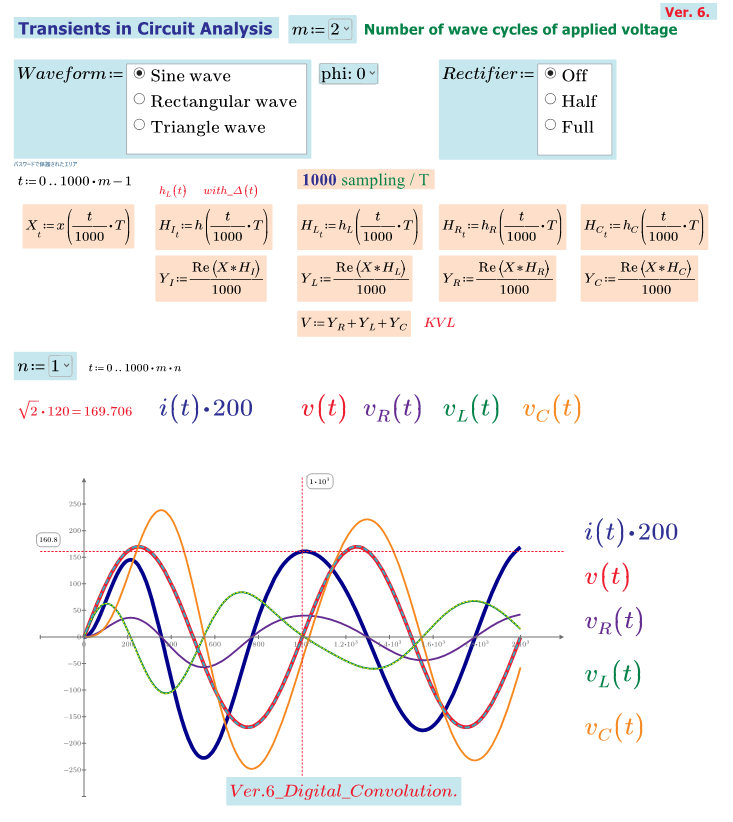

ttokoro
January 26, 2025
Version 6. Solved by using the convolution * of Prime 10.0.1.  Sampling 1000 data for one cycle's period,T.
t.t.

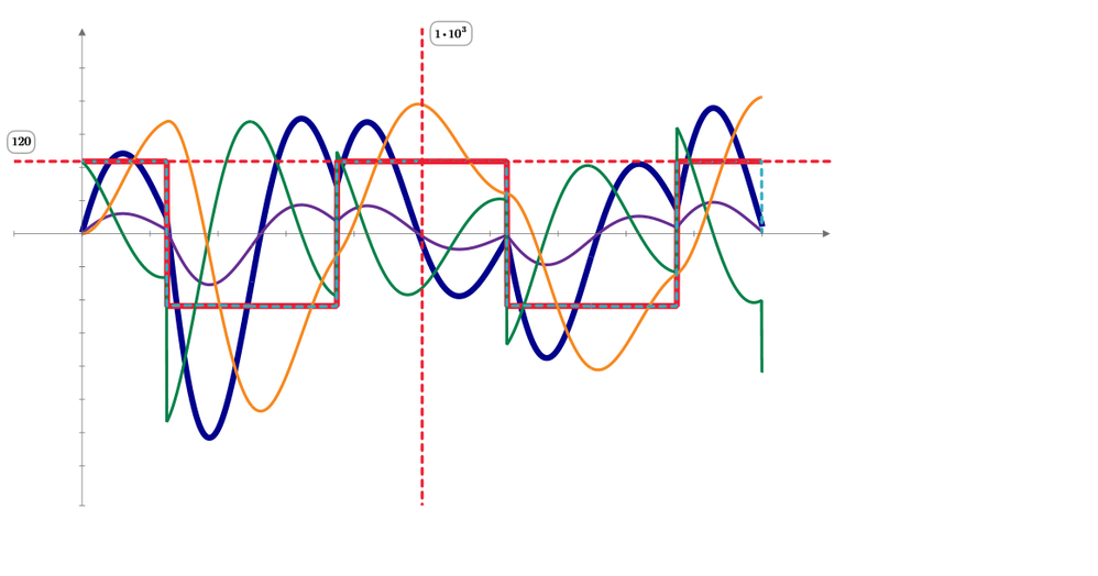

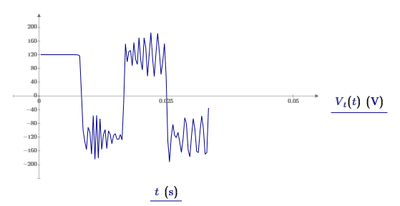

ttokoro
January 27, 2025
Version 7. Solved by using the Fourier series to make 120 V AC wavefroms  of Prime 10.0.1.
t.t.
