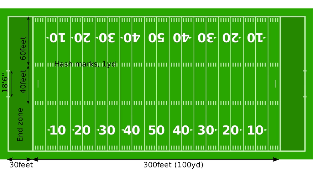

This month’s challenge is around field goals in American football.
Create a Mathcad worksheet where you calculate the following angles from a given line of scrimmage for making a field goal:
  • The horizontal angle between the left and right field goal posts (18.5 feet apart).
  • The vertical angle between the horizontal bar of the goal post and the upper height of the goal post arms.
How can you show how those angles change as a function of the line of scrimmage?2560px-Acre_over_US_and_Associationl_football_field.png
Factors to take into consideration:
  • Assume the football is kicked from one of the hash marks (offset from the center of the field) and 7 yards behind the line of scrimmage.
  • The goal post is located at the back of the end zone. The horizontal bar is 10 feet above the ground and extend another 35 feet. For this exercise, the football must pass through the box defined by the goal post.
  • American football uses yards, feet, and even inches, so you might want to take advantage of units in Mathcad.
  • Bonus: Can your worksheet handle entering yards from “your” side of the field (beyond the 50 yard line)? If not, feel free to use lines of scrimmage in excess of 50 yards.
  • You can ignore air resistance for trajectory calculations. You can also ignore anything pertaining to the shape of the football or its motion through the air (treat it like a point; no need to turn this into a doctoral thesis).
We’re dealing with Euclidean geometry, so the math shouldn’t be that complicated. What matters is your execution. What tools (like plots and charts) can help you communicate the results?

So that I dont have to talk to Bill Belichick can the kicks be made from the extreme left and right offset or just the middle offsets?
November 2, 2022
For this challenge, the kick will be made from either the left or right hash mark in the middle of the field (the ones located 40 feet apart from each other). Not the ones along the sideline that help players judge whether they are in the field of play.
And you spelled Belicheat wrong.

Hmmm!  Did I miss it?  Or have you not specified the initial velocity or the impulse of the kick?  If it's me kicking, the ball won't ever get to the goalposts!  😉
18-Opal
November 3, 2022
Maybe we have to assume that when the ball goes over the goal it’s vertical velocity is zero.
Then we can work out the time and then the required horizontal velocity.
23-Emerald I
November 3, 2022
So the ball stops falling as it gets to the goal?  Does not continue to the ground?  Does not bounce?

November 4, 2022
But if I want to make it into a dissertation....
Does the field run the typical North-South direction?  And are we kicking north or south?

Express can't solve this for a general case.  But a solve block can.
Prime 4 Express file attached.
