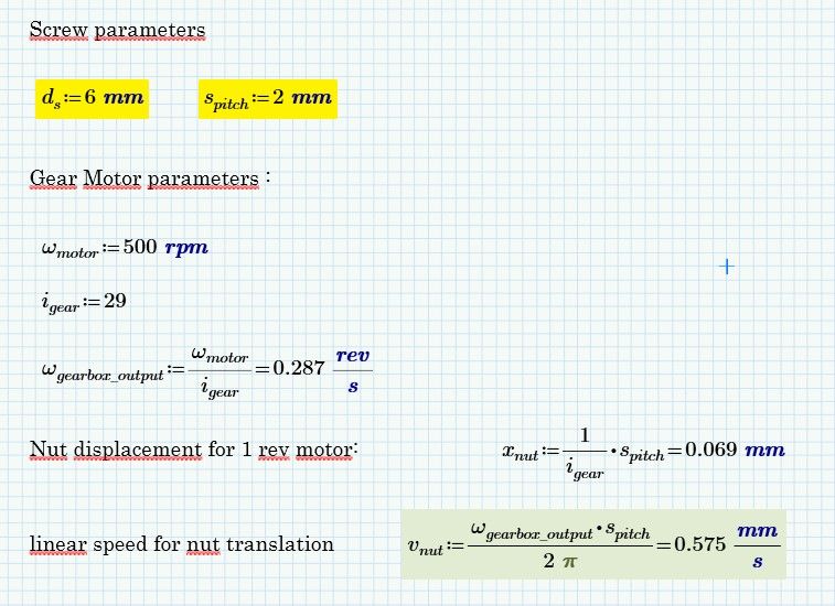

in my sheet:
the screw is : Ø6x2
for one rev, the nut travel 2mm thanks to the helical connection
the max speed motor is 500rpm
the max speed output gearbox is 0.287rev/s (with mechanical ratio i=29)
v.vis_vss33 = 0.575 mm/s mean the nut velocity translation

One revolution of the screw, after the gear box, not one revolution of the driving motor, right?
Still unclear to me. Is this a fictive velocity of the the nut if there would be no gear box and the real nut velocity is 0,02 mm/s as shown??

for one screw rev, the nut move to 2mm
0.02 this must be a mistake on my part
I guess the error was here
as you used the displacement per motor revolution and not per screw rev.

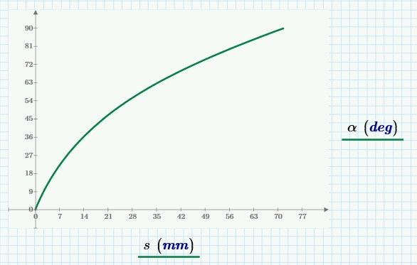

I wrote how I determine the curve
i try to make alpha function with Mathcad loess

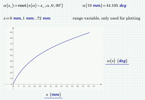

Ah, now alpha and s are defined differently compared to your first drawing!
Personally I prefer working with functions and not with vectors. The function you create (approximate) which gives us the displacement s for any angle alpha could be derived a bit easier and directly that way:
The inverse function (which we presumably need) could be probably derived in an exact way, but its much easier to either use a solve block or the numeric "root" command 😉
Now we have functions we could integrate, take the derivative of or use in an odesolve block, but I still don't know how to solve your initial problem.
I'm used to using vectors, for a mechanic it's more natural. I understand that for a mathematician functions are more natural Anyway thank you for your help. Your writing is simpler, more effective, thank you for that. I don't have the skills to solve this problem. I can't find a way
My point was that you created vectors of values using the exact mathematical functions and then you used a fit function to apptroximate the function you already had used anyway.
Of course you could use the functions I provided to create a couple of vectors if you need them. But to solve your problem, I guess we need continuous functions.

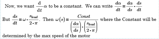

You can find a function of motor speed vs position that linearizes the angular travel in time.
See attached:
