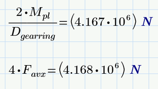

I hope somebody can assist me with this. I am working on a calculation for a planet gear with 4 sun wheels and 1 planet wheel. The aim is to determine the forces on the sun wheel. Initially, I have 3 equations and 4 unknowns. By making an assumption based on symmetry, I now have 4 equations. Unfortunately, I am not getting the correct results. Does anyone know where I can find more information on this or perhaps have a tip? Is my assumption correct regarding the average forces over the teeth? Thank you in advance.

I can't comment on the correctness of your calculations and assumptions but all I can say is that the first and second row of your matrix A are clearly linear dependent (on is all 1, the second is all 1/4). The rank of the 4x4 matrix is 3 and so, as you also show in your sheet, the determinant is zero and therefore you can't calculate the inverse of that matrix. The corresponding system of equations would not have a single solution but probably an infinite number of solutions, depending an a parameter. Its also possible that there exists no solution at all.
I understand that you are looking for a unique solutions, so you will have to look for an additional. independent equation.
BTW, in your vector b the first entry should be exactyl 4 times the value of the second entry. Maybe due to some round off errors it isn't

I'm thinking that based on the assumption of symmetry, where the arms are equal in length and the forces are equal on these arms, this could potentially be the solution. Indeed, the determinant of the first partial sheet doesn't give
a solution. Based on the four-moment equations per gear arm, this could provide a solution. ( Assuming that the arms, tolerances, and geometric dimensions of the wheels are equal. There are likely other methods; I'd appreciate hearing about them, any points of improvement, or if I'm completely off track.
