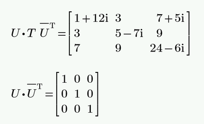

Terry,
See attached - I think I cracked it.  I finally got Schur decomposition to work on matrix with a mix of real and pairs of complex conjugate eigenvalues with reduced iterations.  Also added routine to get eigenvectors from Schur decomposition. 😊
I think this should be considered an accepted solution. Do you agree?
Now need to work on a Mathcad version of the Jordan decomposition with repeated eigenvalues.

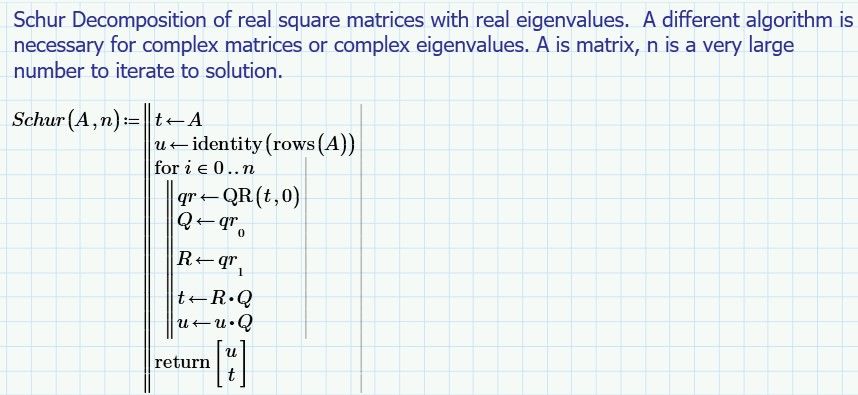

Hi Larry,
Here is the Schur decomposition for real matrix and real eigenvalues, have not developed the complex number algorithm yet.

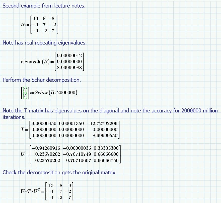

Following are two examples from different sources.
Cheers
Terry

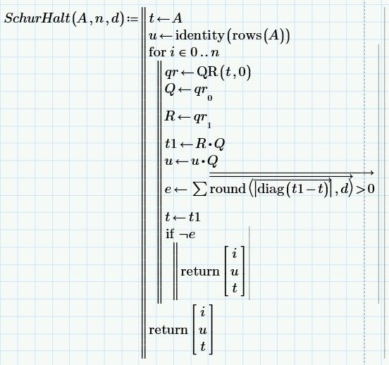

May 1, 2023

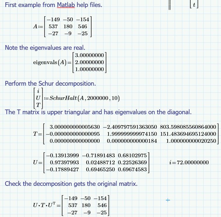

Realize the iterative solution often needs far less than 2 million iterations.
Here is a solution that defines the maximum number of iterations "n" and an accuracy in decimal places "d"
Cheers
Terry

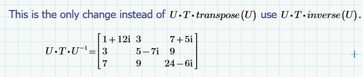

This is better solution -- will it work for complex matrix?
What is
